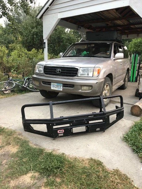

I got a deal on this 02-07 FJ100 ARB Delxue bumper, but I have a 2000 100 series cruiser. I'll be putting it on today, does anyone know what modifications if any will be needed to fit to the 2000 model?
I have all the original hardware. And will be installing it without a winch.

Thanks guys, got it done, only issue was I had to re-drill a rusty bolt that wouldn't come loose. Will probably run into lots more of these as I continue to work on the ol' family car that's been through 20 Wisconsin winters.
Will get fog-lights and blinkers rigged up tomorrow.

Fog Lights and Indicators (from a Tacoma kit) work like a charm!
