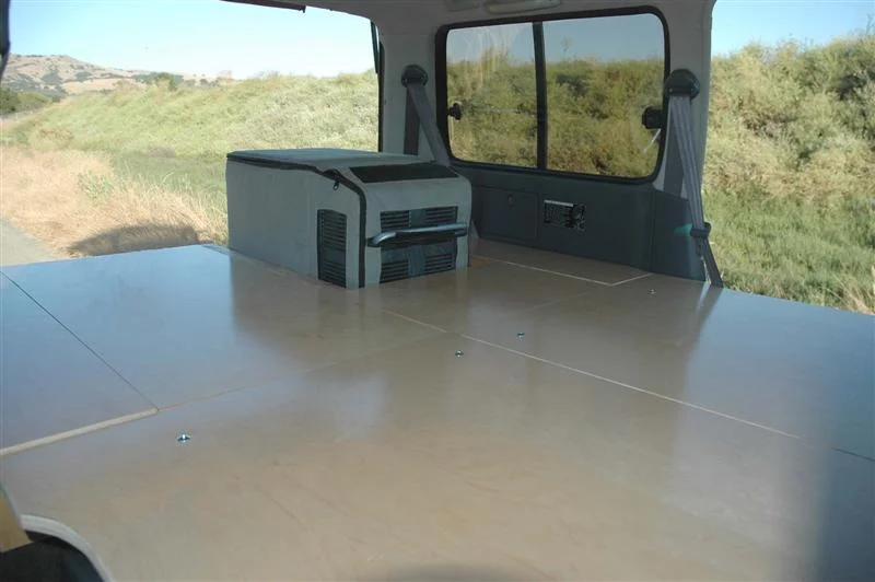

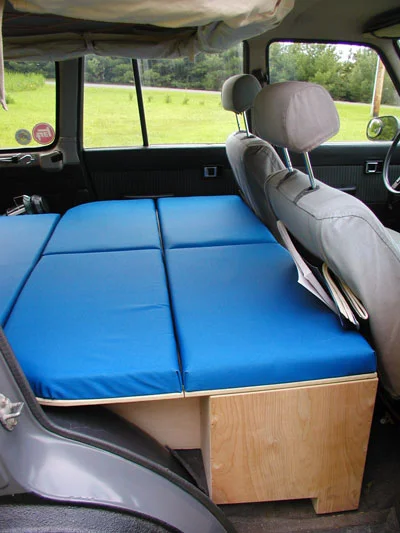

I am looking for ideas on how to mount the front portion of a bed system to the drawer system I have in the back of the 61.
I have a standard two drawer box in the back and I would like to see what people do to attach the front part of the floor that makes up a bed.
My rear seats will be out and I would like the top to be two pieces much like this pic but I would like to see a pic of the system from the view of the rear door. I am having troubles figuring out what the best way to attach those front peices is going to be.

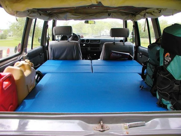

I've made something similar to this for my 60, Roller drawers and fridge in the back, then rear seats fold down and 2 panels sit on top, works really well. I've also fabbed up a couple of fold up extensions behind the front seats that pop up when you fold the front seats forward, adds another 20cm or so of length to the bed. I'll try and get out tomorrow and take some photos for you.
My idea is to make my cargo barrier attach to the top of my drawer system and fold down to rest on top of the tumbled forward seat bottom. I can then add a sleeping pad of one form or another on top of that. This will leave plenty of room for the kids to crash and hang out but still make the back seat available for the kids.

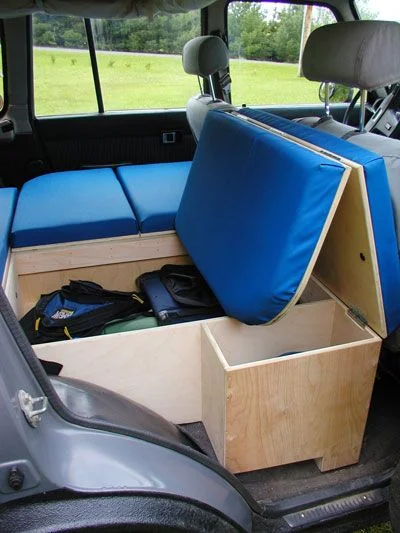

^ thats nice.....do those front panels remove easily when needing the rear seat.

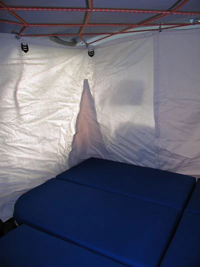

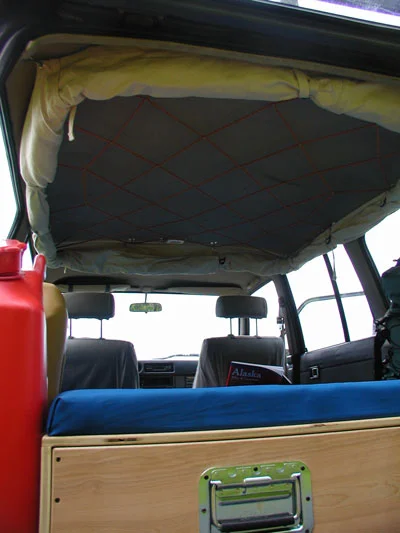

does the roof drop down to make up a curtain all around you? Very cool set up. It looks like your front piece folds up for quick storage??
yeah i'd like some more info on that curtain setup as well, i've been trying to figure out my plan of attack for that for some time and looks like you got it nailed.
It has gone through a few changes since these photos but over all it has worked very well.
There are 4 bolts that thread into T-nuts in the main drawer box. Remove them and the front bins come out (a left and a right) to reinstall the seat.
The curtain rolls down all around the bed, now that the windows are tinted it doesn't get used as much, but is really nice to have.
There is a different front sleeping platform for use when the bench seat is in place, I don't have a photo of that right now.

I like how that front part works. How did you attach the foam to the lid?

The foam is glued to 1/4" luan with 2 T-nuts sunk into it then covered with that fabric (which has since been changed) You can see one of the pan head allen drive bolts that threads into the T-nut in the above picture.

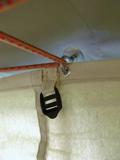

Was going to use nut-certs but if you drill in the right places the metal is just thick enough the run a tap through.
The eye bolts are threaded in with a fender washer and a nut that locks it together. Surprisingly, they have held for over 40k miles. I think that the constant tension from the cargo net (which rocks way more than the curtain) has kept everything tight.
The curtain is a super long rectangle (20 or more feet IIRC) that is split between the front seats so you can climb into the back.
The corners had to be gusseted because the roof is smaller than the sleeping area.
It's made out of canvas
There are structural channels that run all around the roof, It really helps to have a gutted cruiser to look at. If not, you can feel around the headliner and find them.
