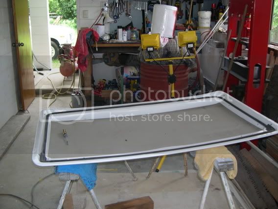

Well, i managed to remove the w/s frame without touching the roof (thank goodness).
As long as you remove all nuts (including the 6 or so hidden behind trim at the top of the frame, its a fairly pain free job, however it does require a little bit of gentle persuasion.
My original frame was absoloutely shagged! Rusted to bits and simply dangerous.
There was a little bit of rust evident at the top of the bulkhead which was found when the rubber seal was removed.
I found that the seal was in pretty good condition and I think I may have found a way of curing or at least vastly improving the sealing ability.
When I removed the frame, the seal seemed to have lifted slightly (proably allowing water to be driven in in the rain at higher speeds) making it look as though it was perishing and losing shape. I removed it the seal, washed it down and doused it in Armourall to try to soften it. I placed it back on but it didn't seem to sit very firmly so I removed it again.
I noticed that the seal sits on a lip at the top of the bulkhead. As a part of the seal there is a firm folded area which should squeeze down onto the lip. The folded area was "open" in its feel so I finger squeezed it to a tighter fit and found that when it was paced back on the lip on the bulkhead, it say flush with the surface. To ensure a better seal, I then sprayed on a lanolin based spray to A) form a waterproof cover for the bulkhead and hopefuly prevent future rusting and B) form a seal between the main rubber seal and the top of the bulkhead. When this stuff dries, it becomes sticky so I hope to it will serve to help keep the rubber in place ( like a mild glue) whilst protecting from water.
As this is a pretty straightforward operation, I'd advise anyone with leakage problems to give it a try. Even if it doesn't pay off, its a good chance to slap some silicone of simlar in place and sort out any rusting. Just allow your self a few hours. We did it all in about 3 (including beer, burgers and bum scratching)
The new FRP frame was then placed back on and with a little help from a couple of mates was fitted loosely into place.
It was then a question of getting the seals fitting correctly around the top of the pillars, then FORCING the bolts back into place. Some went in fine others are simply too short or the thread is too worn, so its off to the hardware store tomorrow to get some slightly longer versions.
A word of warning though, for those of you with access to the FRP panels (probably those in Oz), you may need to drill two holes in the very top of the FRP item to help bolt it to the roof. At present the roof sits about 1cm high in the middle as it is not bolted down properly. I need to use a mate's drill, carefully bore new holes and put the new bolts in. However after then, there is no option to re-fit the trim which sits at the top of the screen between the roof and frame. A minor thing I know and with a bit of blag fab, I could get it back on there.
I guess you just need to be aware that the FRP frame doesn't come absoloutely ready to swap.
I did have the camera at the ready, unfortunaly the batteries didn't come to the party so nil pics I'm afraid:o
Will let you know how things finish up.
