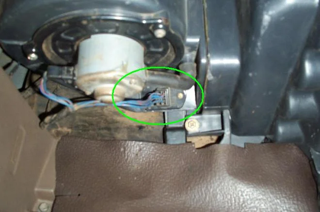

After figering out the problem with brakes, now i have another problem with the fan, doesn't matter if its cold or hot air, the switch works only on the last 2 settings. It does sound like the blower resister. I am not home and don't have a manual handy. Question, where is it located and how difficult is to replace it?

It will be nice to se some picture or diagrame about that
This is on a RHD:

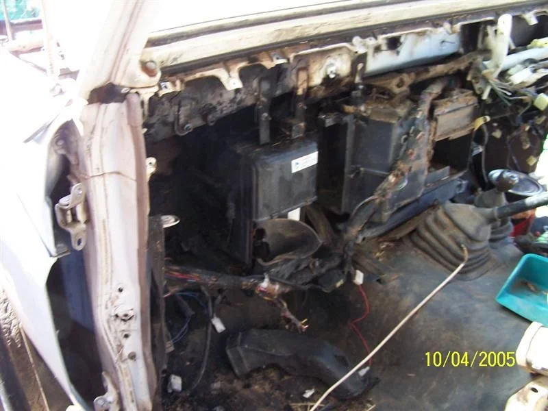

Greg_B said:
And how the resistor should look when you remove it. Be very careful when removing it. This seems a dust collection area, and I have seen huge dust bunnies intertwined through and around the coils. Perhaps the heat from the coil, and the collection of crap react and burn out the coils...I don't know for sure though.
hth's
gb
I think thats what caused that 75series cabin fire I posted pics of some months back.Cant repost as my computer has died:crybaby: and :mad:

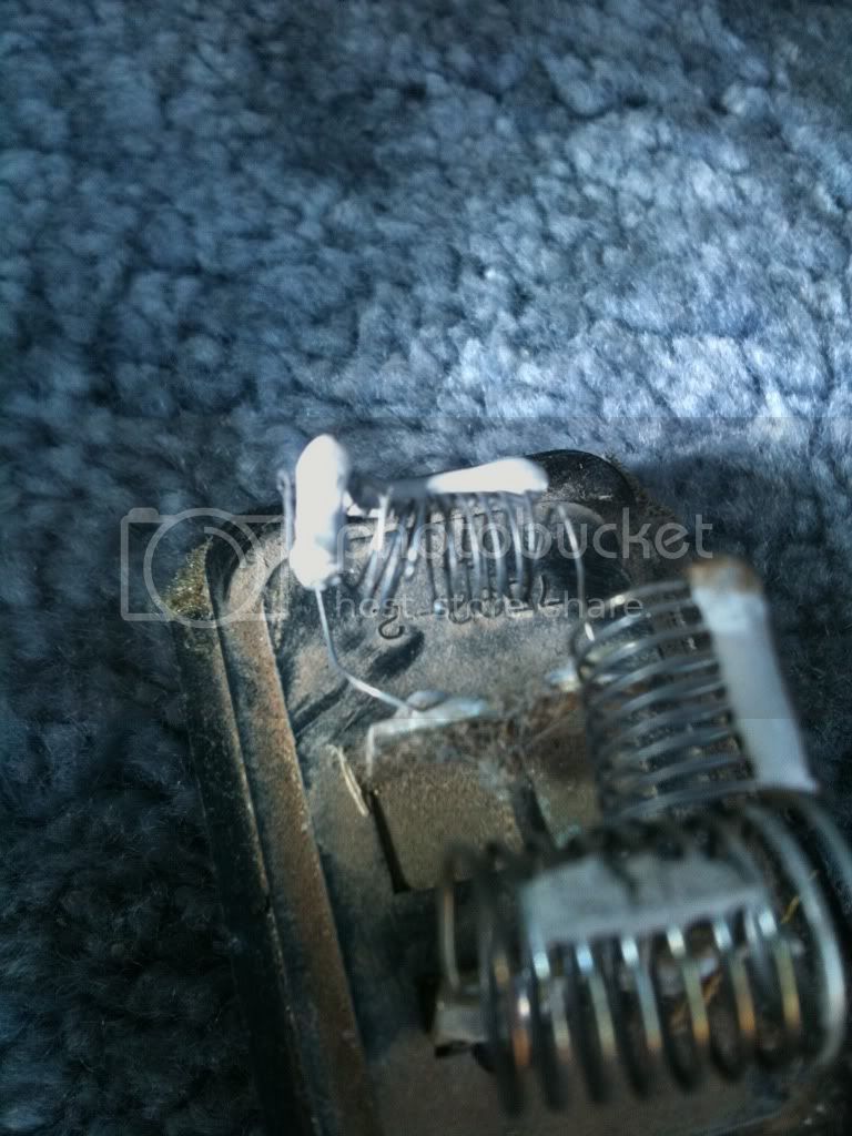

I removed the resistor and found that the middle coil is separated to two parts.
I creamped them togeather and it works, but I will try to find a new or a used one in good shape. Do you guys know if the one from FJ60 or FJ62 will work or it has to be ONLY for 70 series?
Thanks,
Alex
With the smallest resistor circuit appart the fan speed 1 would not work 2,3,4 would work
