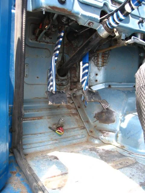

Here's a few photos of areas of the FJ45LV I'm glad I didn't know about when I drove it home!
The brake hose was "patched with electrical tape, the brake line was welded/brazed in several places and the spring pin isn't even bolted in (not to mention the wrong one)!
It's good I plan on tearing the FJ45LV apart COMPLETELY. I've already found a steering box full of grease and the adjusting shims laying in the bottom in a mangled pile, a rubber cork for the front axle drain plug and the drive shafts were each held on by two bolts at each end and the list goes on!
I crashed my Chevy on the way home the day I bought it. Brakes went out, no parking brake....whoops!
Now I tow them home and never expect to drive them until I can at least go though the important parts.
This may have been your first clue....tassels on the pedals are the coolest :D
Yep, that should have said everything! Actually, it likely is safer to drive it than to try towing especially in Guatemala City. I was REALLY gentle when I drove it. Even then it overheated due to the busted altenator mount which caused the belt to jump off. I ended up towing it the last 1/2 mile or so with a tow strap behind the '60.
