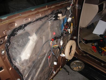

Cool, and the grill/cover fit over the speaker without any problems? What did you use to fab the 3cm spacer?
A MDF plate. The grill fit like before. Look at the pics.

Jukelemon said:
How does the door panel come off? Any tricks?
No tricks. Just handle easy and carefully. On front doors you have two screws with caps (obviously you must first remove those caps), and one below the knob plastic. Other screws (on the bottom) are visible. There is one hidden screw below the window control plate. You must take out this plate first (with help of screwdriver from front side of the plate) to see this hidden screw. On front doors you must remove a tweeter plastic before removing a door plate. I have difficulties with removing knob plastic. You must be careful, and with a help of adequate screwdriver raise the upper and after that lower part of plastic. After first time removing those plastic you will see the system and after that it will be very easy. After you removing all screws and knob plastic just pull door panel and lift they up. Voila.
Sorry about my English. I meant plastic frame which surround a door knob. I hope this description is understandable enough?
