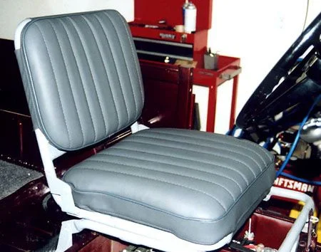

Post up some pics of them installed please. Are those the same ones that are on Marv's tan 25?
From what I've seen all 25's had tan upholstery, not a very nice color at that. But this is a nice shade of grey. Sorry about the pic, my digi cam sucks.

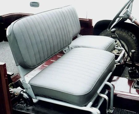

I also got the rear bench seat upholstery for when I find a frame :D

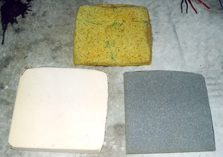

I bought 1 inch, 2 inch and 3 inch thick sections of seat foam from an auto upholstery shop for a total of $30.

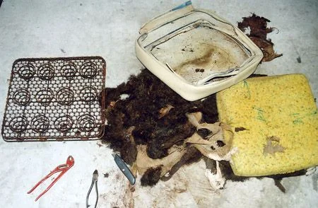

1. Stripped off the old covers. Yikes, it's scary inside of there!! :eek:

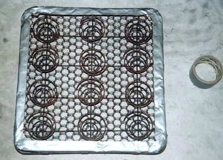

2. For the bottom part of the seat, I used the old cushion as a template to cut both a 1 inch and 3 inch pad.
3. After cleaning up the spring box and even though the edges were pretty smooth, I ran a strip of duct tape around the perimeter of both levels just to be sure.

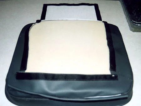

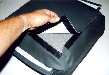

4. Inserted the 3 inch foam into the new bottom seat cover. (Center it until it's perfectly situated.)

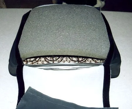

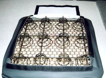

5. Centered the spring box on top of the 3 inch foam.
6. Placed the 1 inch pad over the spring box. (It acts as a buffer between the springs and the bottom fabric.
7. Start tuckin' and firmly (but carefully) start lining up the Velcro strips. It's going to seem like you're trying to put double size sheets on a king size bed, but with some compression on the springs and foam, it will come together nicely.

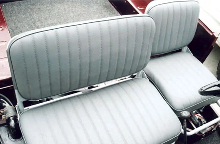

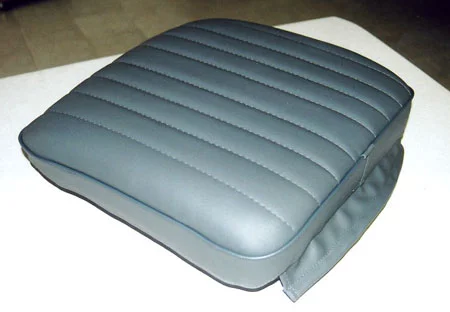

8. Flip it right side up, and here's how it looks.
9. The back cushion is a piece of cake. Just use the original cushion as a template to cut the 2 inch foam to size, stuff it on in there and seal it up.

12. And, you're done!! :bounce:
Total time for a first-time auto upholsterer to do both seats: 1 hour 25 minutes (including picture taking, a cold piece of leftover pizza and three cups of Starsbucks). :cheers:
Looks great Steve! My upholstery doesn't look quite so good, but it will pass for now. That horsehair and burlap is scary stuff though. :D
Wow Steve, those look great. Nice job. Good to get rid of the horse hair & burlap while making your seats look great. I just took that stuff out of the LV and replaced it with foam too.
