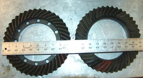

Tecnically no. With his resources he retro-fitted an 80 pumpkin into the 100 and it cost BUCKS. This is also a step backwards however. By putting a 80 R&P in you give up strength. Toyota beefed up the rear R&P on the 100 probably to accomodate the added power, torque and weight. I will wait for a proper sized "100 gear" rather than taking the step backwards in durability (even though the 80 gear MIGHT hold up).
Tehcnicall Yes, It was not really a step backwards. We retained the 32 spline axles. The 100 Series Ring gear is not bigger in terms of OD, It is slightly bigger in terms of gear width. See attached picture. The 80 ring gear bolts though with bolts and nuts on the flange, whereas the 100 series bolt into the gear.
80 gears on left, 100 gear on right. In both cases from a open carrier.
