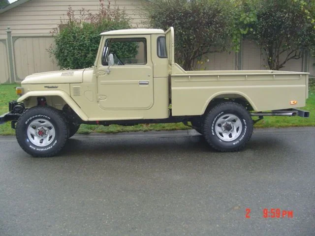

Radd, how much are those spaced? I've got some Sequoia steelies I'm putting on my 40...and need 1-1.5" spacers...
Back spacing was all wrong at 4.75, after opening the box and measring the back spacing my toyota guys were not looking forward to returing them.
Took them back and they fit, the larger diameter allowed it to clear, plus the 285s only rub on full turn right. Small adjustment and it works great.
I really was pleased how they stayed inside the trucks wheel wells.

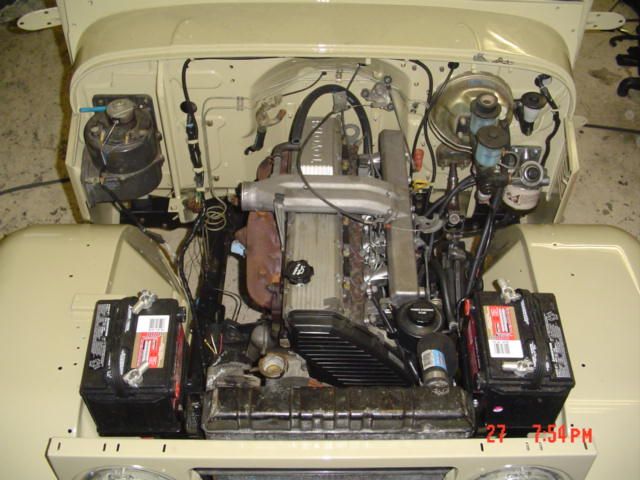

More eye candy for you diesel folk.

Keep an eye on ebay for those stock 16" steel units... you can snag new take offs and low mileage wheels on there cheap!! Around $100 - $200 per set.
Boingggggg!!! Awesome.
Although I think I might like them better without the hubcap. More militaristic.
Could be the low light, though.
