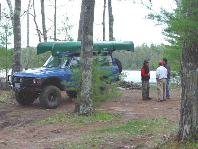

It was my daily driver for a couple years.I only drive 11 miles to work and back and no daily freeway driving.Camping road trips with canoe(s) on roof with no probolems ,just drive carefully!
