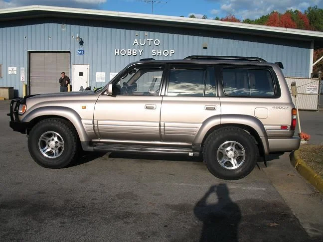

This is after the install.

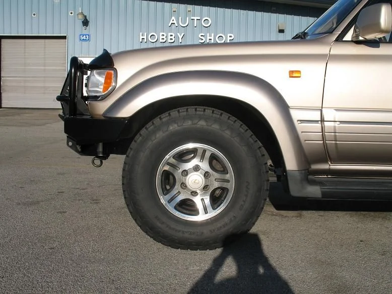

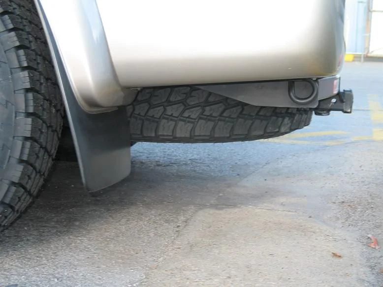

Spare tire hanging low. I need to hurry up and install the OME lift. Shots of both front and rear tires.
Man that rig is begging for a lift....Looks good though.. What do they come out to in tire diameter, 34's?
They are 33.2 tire diameter. Yeap, it's really begging for a lift. Thanks.

i have been way impressed w/ those tires off road, for an at. looks good, thats the size im tryin to get my brother to go with prelift as well; any rubbing issue around town on the pavement?
I'm running 295/75R16 M/Ts on my truck. I measured mine at 33 3/4"...
I was surprised to find they didn't rub, even with no lift. Of course I'm lifted now anyway :D.

I've got 295s on mine (Hankook Dynapro MTs) and I was able to wiggle the spare so that it tucked up a lot more than your has in the picture. The rear of my spare is flush with the factory tow hitch (if that makes sense). Anyways, if you loosen your spare, move it around a little and then retighten it, you may be able to tuck it in a little better to give you some more ground clearance. If you do hit the trails, make sure you take it off and throw it in the trunk so you don't bash it on anything.
No rubbing at all on pavement, I have not tried them yet on the trail.

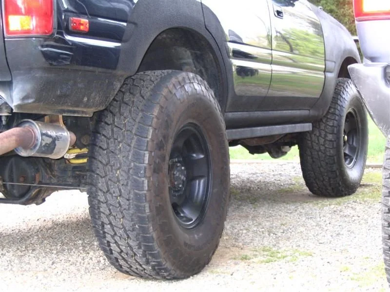

What is a dynabead? Oh by the way, your tires are kinda wearing out on both edges, is that the sign of low pressure tires?
Go to innovativebalancing.com to get these little beads that go inside of your tires to balance them instead of using weights. Cool things are, no weights, and always stay balanced.
Funny about the tire wear in that pic......actually that was the day i drove home from having them mounted. They had put 48 lbs. of air in them; so they were riding in the centers. I aired down to about 34 lbs. and they ride great and wear even. :D
