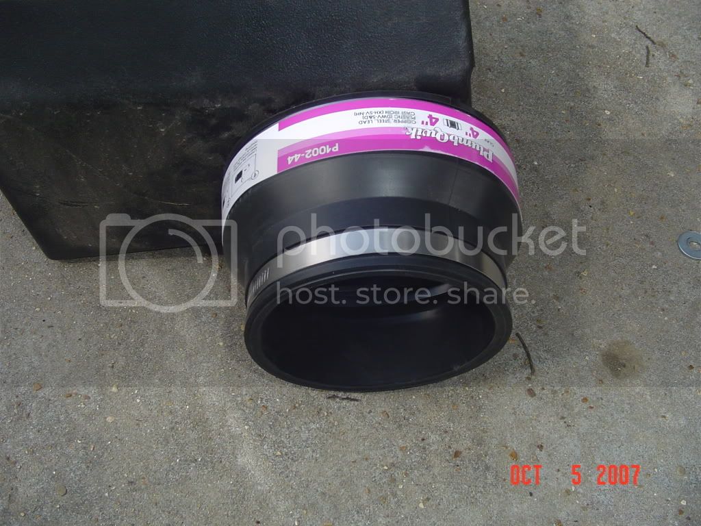

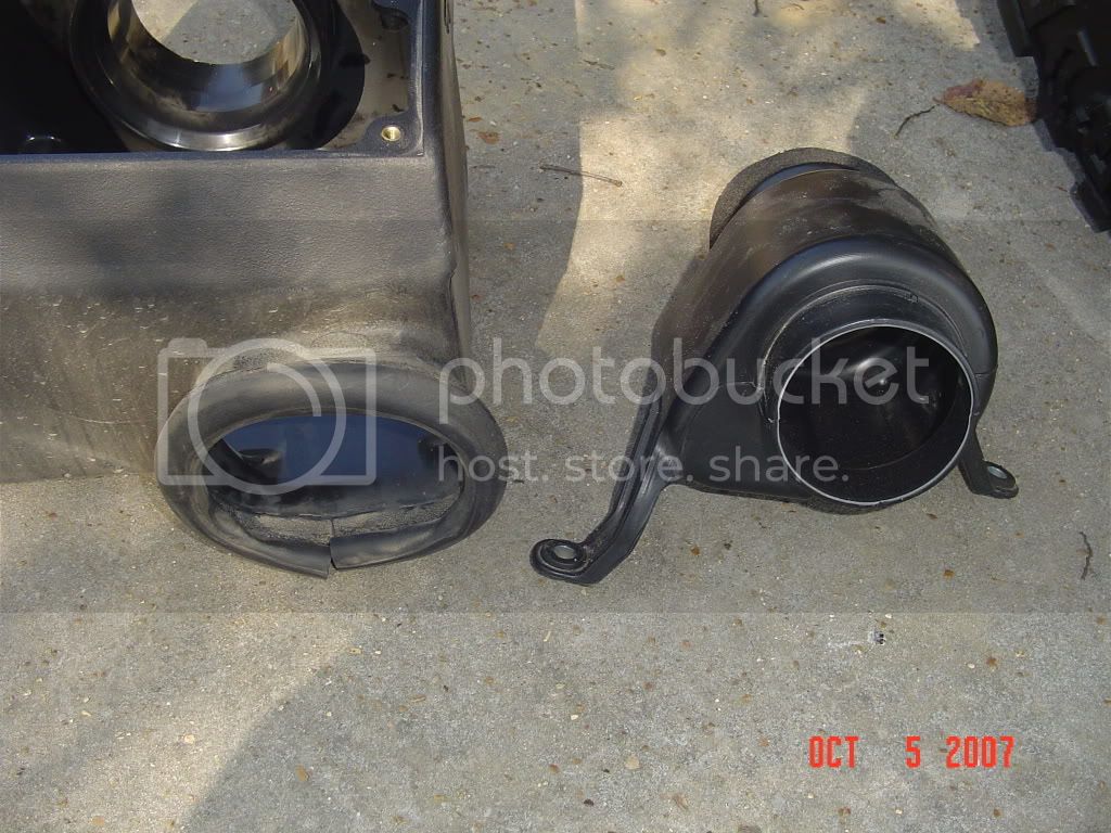

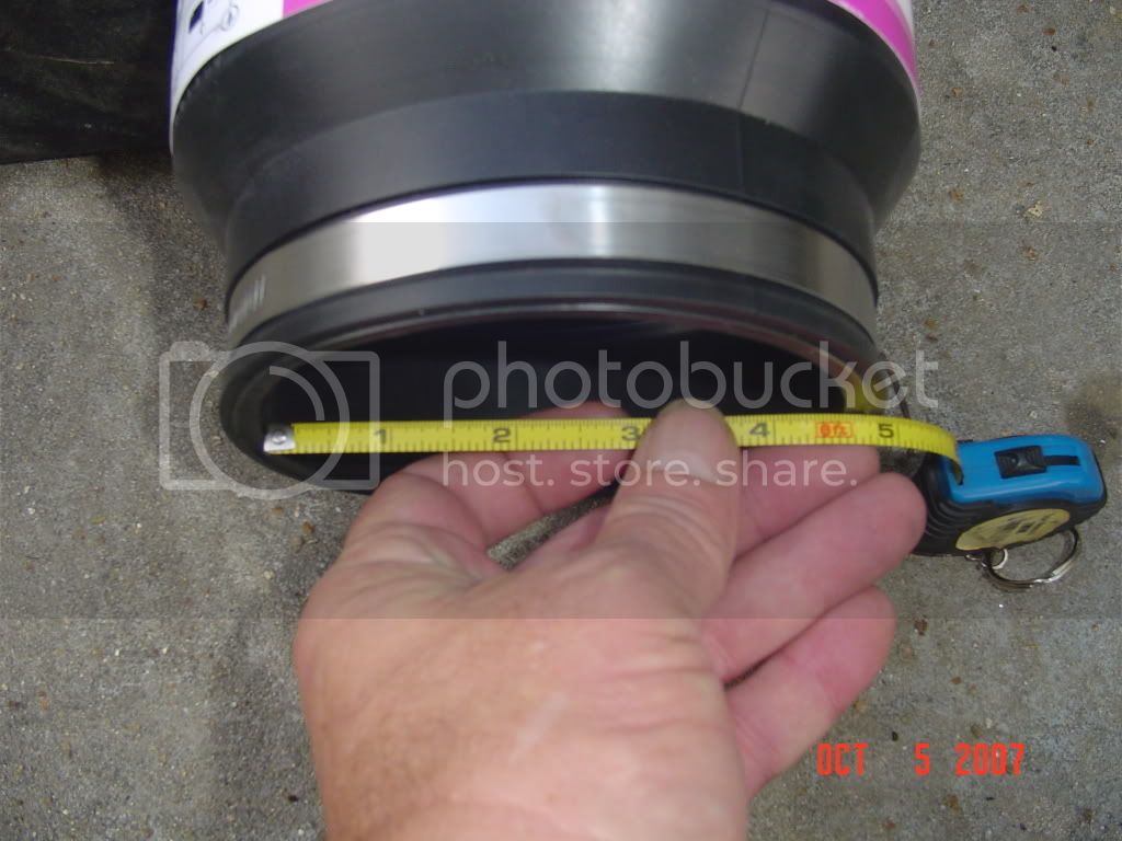

Anyone that has a TRD or URD CAI, here is the MOD Install information.
I removed my CAI box this afternoon to check dimensions for the intake.
The CAI box intake opening is oblong shaped. I thought this was going to be very challenging to find something that will fit over it and remain water tight.
So off I went to my local Hardware store exploring all the nooks and crannies for anything that would work. I was on a mission, the fate of the Snorkel / CAI group weighed heavy upon my shoulders. Alas, I may have found exactly what we may need. I made my purchase and rushed back home to disassemble my CAI again.
I found it would stretch perfectly around the strange shape opening and would secure it tight enough for no water to penetrate. The next problem was the reduced side is still to large, it needs to be another inch smaller in diameter.
So
I ran inside googled up the manufacture and went through all their fitting and low and behold the perfect one, the one that I have been searching for! Number 1002-43! The I.D. is 5.25” x 3.38” I.D. awesome, so with part number in hand, I rush back down to my local hardware store, and ask if they would order one for me. They look in the book, and say, nope we can’t order that part, it’s not in our book. I say, ok, I’ll go order it online, thanks. I returned the other one.
I return home and jump on the computer and look up the number to the manufacture, and make a call. I speak to some lady on the other end. I ask her that I would like to place an order, she asks what’s the name of my company, I say, I’m not a company. She say’s sorry, we don’t sell to the public. I say ok, can I have one of your large pluming supply companies, I will buy it online. She say’s, I don’t know of any…Now I’m getting a little frustrated, so I state, that’s fine, I thank her, hang up and googled the part number with the name of the manufacture. I find an online hardware store and find the part 1002-43 then place my credit card order. https://www.mclendons.com/item.asp?sku=61013760&from=search
Now it’s just a matter of time until my Snorkel/CAI adapter arrives in the mail. Stay stunned everyone, more details and pic’s to come
