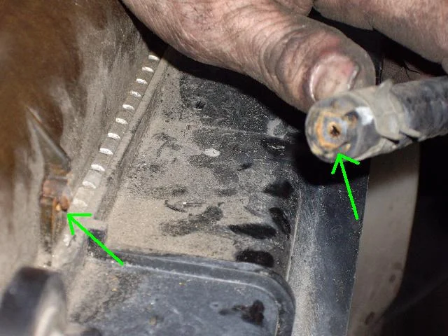

Nonetheless, I'm not a very large person, so when crawling to reach the rear of the engine, I heard a cracking sound and knew I was in trouble. I broke-off the bypass No. 3 fitting from the plastic top of the radiator. Here's a pic:
So my question is: Is there any way around this? Has anyone threaded a new nib into the radiator top or something similar? How big a job is replacing a radiator? :mad:

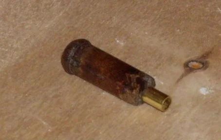

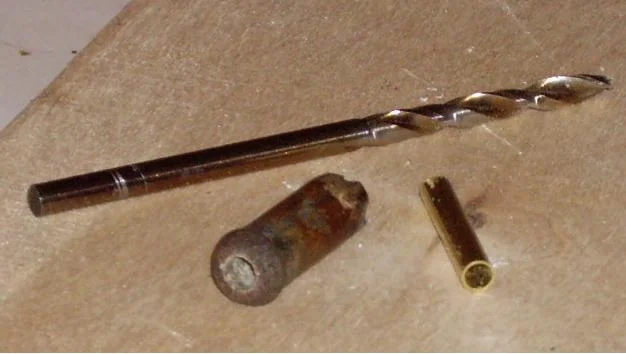

Picture 1: The broken nib, a piece of 5/32" OD brass tubing, (leftover from my Megasquirt project, but you can get it at most RC hobby stores), and a 5/32" drill bit.
Picture 2: The plan. Clean out inside of broken nib with drill bit. Fit section of tubing inside broken nib. Use drill bit to clean out hole in radiator. Press exposed brass sleeve into radiator hole and glue using high temp epoxy. Glue-up will be inside another sleeve.

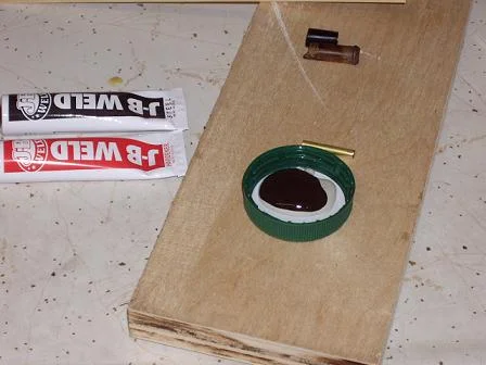

First Picture shows the materials. I'm using an unshrunk section of heat shrink tubing to sleeve the outside of the repair. I cleaned everything with acetone and got ready for the glue-up.

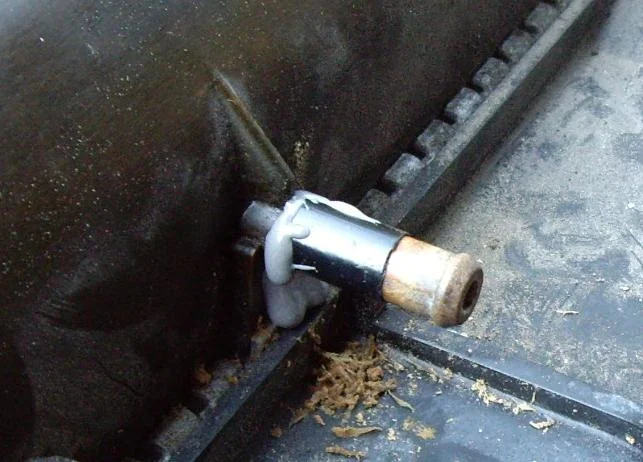

Second Picture shows the sleeve surrounding the exposed brass shaft. I plugged the shaft and filled the sleeve with JB Weld. I couldn't find anywhere on the packaging stating that JB Weld works on plastic, but it had the highest heat tolerance of any of the epoxies at my disposal.
Third Picture shows the glue up after un-plugging the brass tube.
