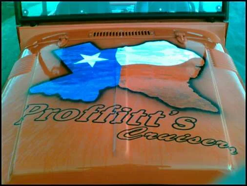

Bob's work is one of the most important part of Jeremiah's business. His quality and attention to detail is unmatched. The pic shown is from my phone, but shows Bob's artistic ability that is truly the "icing on the cake". It was an honor to transport that for Russell and Matthew.
P.S. Russell*** I just realized I have your 9/16" wrench... weather delay on leaving Dallas... I'll get it to ya!
Hope ya enjoy Meanie!
B

Thanks again Barry and Kudos to BOB !!!
