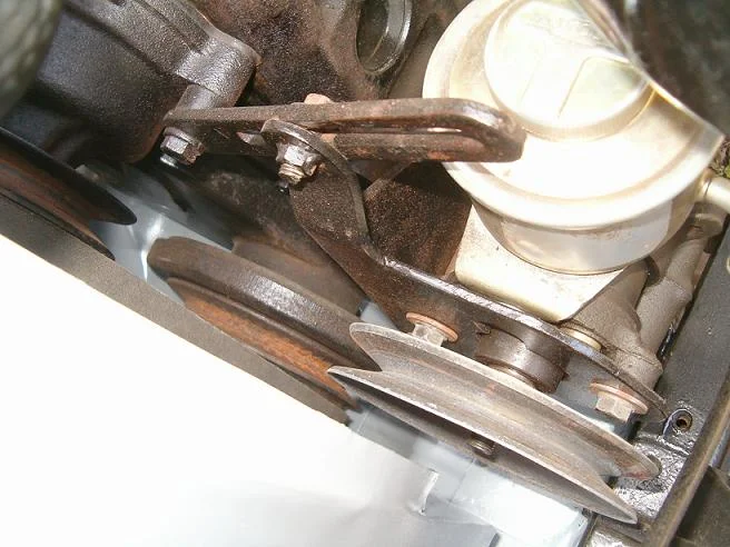

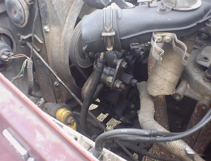

On my 74 I used a 60 pump and made a bracket to fit the alt mount on the driver side of the F engine. My pump lines up with the inner pulley and my alternator I moved to the passenger side with a 78 mount lines up with the outer pulley. The pump mount has an adjuster and I run 2 belts.
Does your harmonic balancer and water pump have 2 pullys?
Kevin

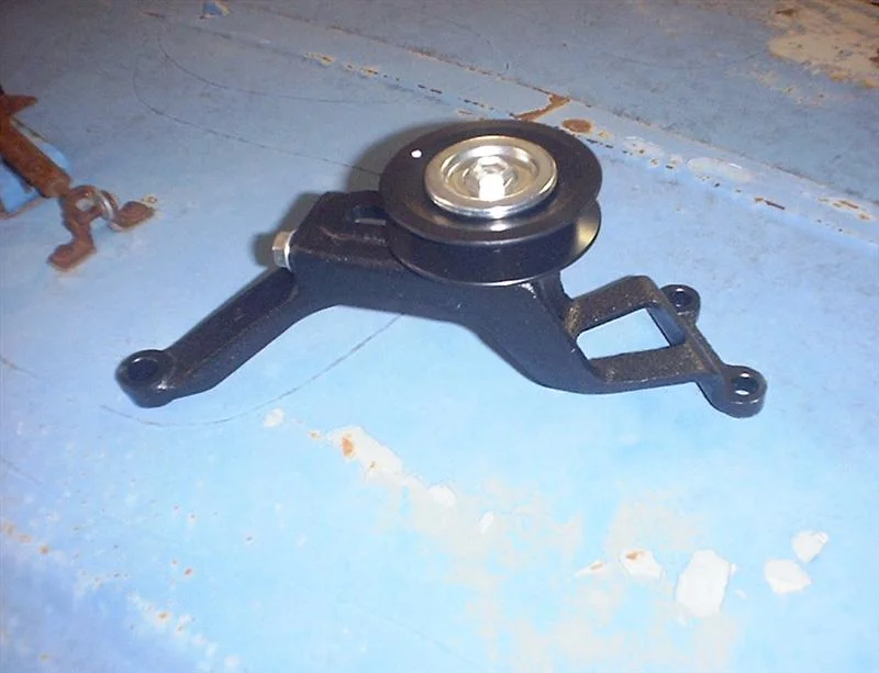

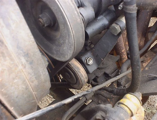

Here is a pic of a idler.. Toyota # 16630-61020 used on 3F applications.. over the years I've made use of it on several different p/s scenarios.... it is used in this pic as a smog pump eliminator.....

that might work also. Thanks everyone.
