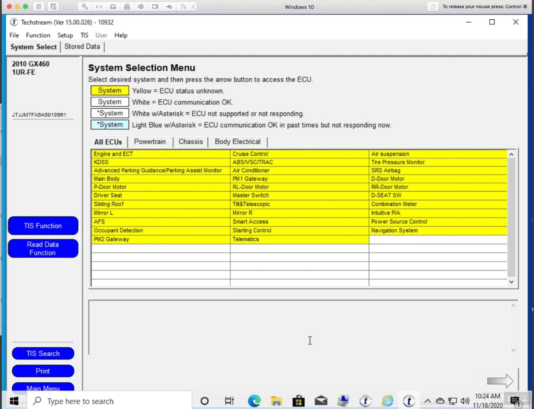

I am wondering if they took that out in later versions? I've only used up to version 12 of TS. You can get older versions here. I had heard key programming got taken out in V14 IIC. Customizations should be right there on that 3rd graphic.

Works! That was much easier. I guess I'll keep both v15 and the v12 that I got from that thread in case the v15 helps better with trouble shooting in the future but all I really wanted to do was customize the settings and maybe use it to do the crawl control install if it's easier than sticking paper clips in the OBD.
