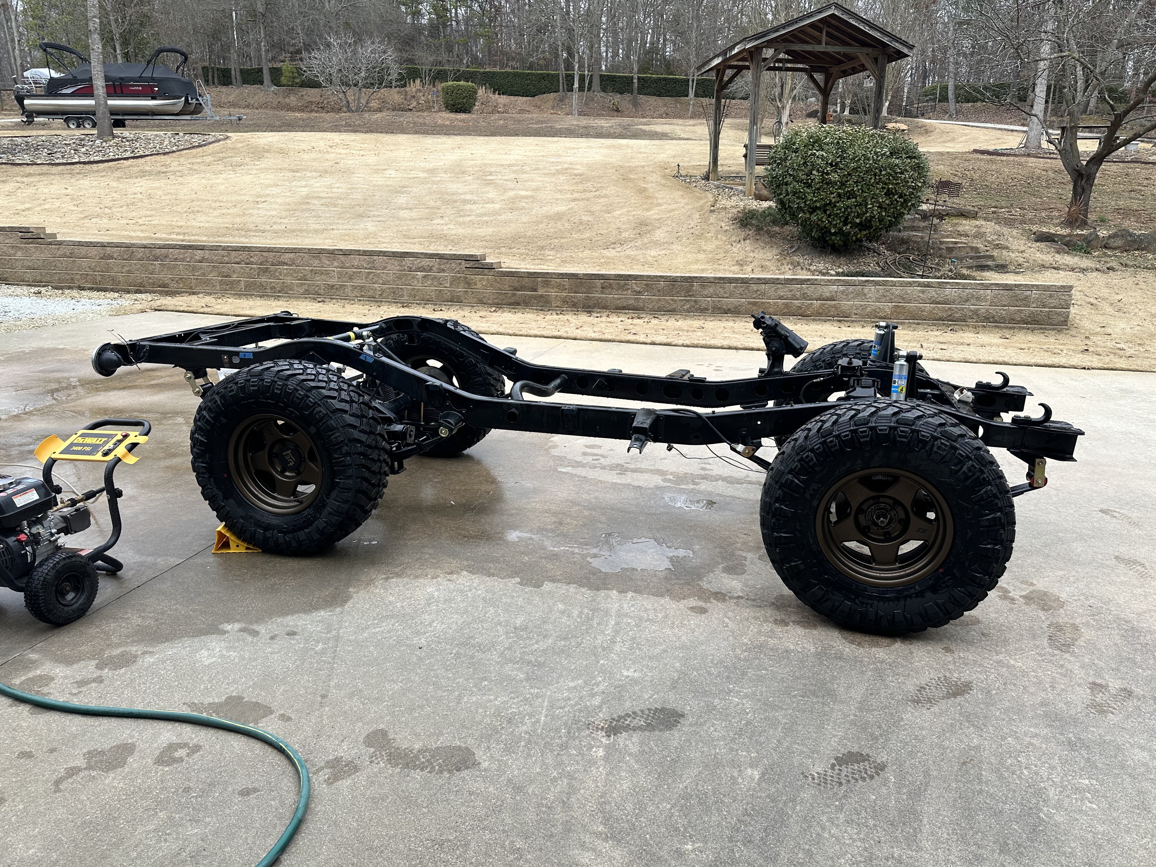

Body was removed to allow the frame to be sanded and painted. Blue tape marked the various sized body mounts. The PS box shown on DS was identified as an F150 steering box - That was scrapped and swapped for Mini Truck which I will detail later. The rear crossmember was cut later to accommodate the H55F and a DIY brace was fabricated for the swap and to sustain rigidity. I will cover crossmember mods and any custom cutting/frenching later as well.
