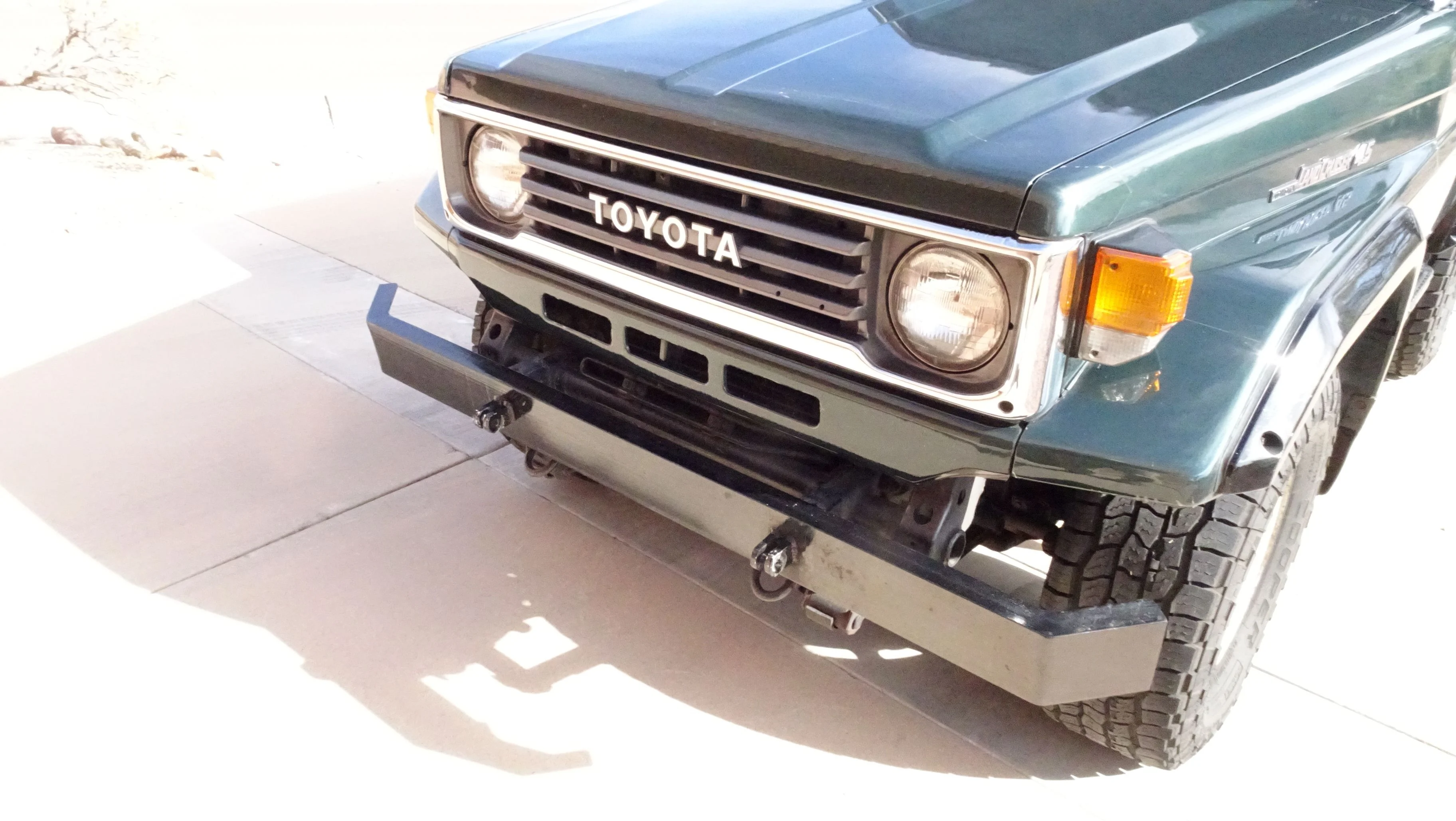

Custom Bumper
Built of 6" "C" Channel with ears welded to front to accomodate Blue Ox Tow Bar. Shaped to mimic Stock bumper curves. Webs welded into reverse side to bolt directly to frame rails.
