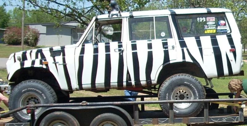

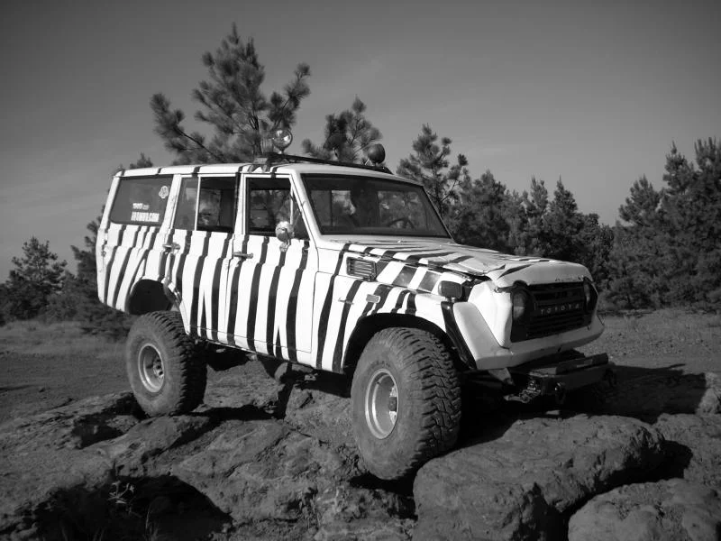

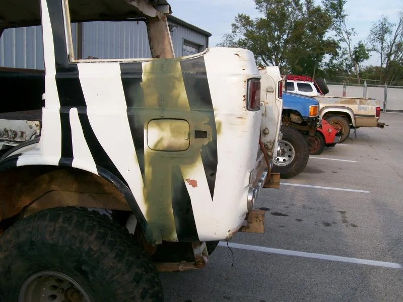

I bought the truck for $1,500 and it ran "okay". I had to tow it home because the clutch slave was bad and it didn't run well enough to clutch-lessly. It had an awesome zebra-print paint job, some 31" Cooper Discovers, and a savannah-heat air freshener (the zebra print matches the paint job).
I didn't do much with it till the spring of 06' when I bought a header, Webber 38/38 (now for sale, PM me), and a clutch slave. I was parting out my FJ60 after a completely failed attempt to sell the vehicle as is for $1,800.

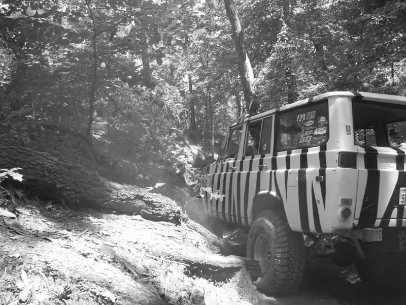

Finally, in the spring of 07’ I took it to Barnwell MTN off-road park for the first time. I quickly discovered that I had “phantom” 4WD. The hubs weren’t locking out and thus began the next phase of build up.

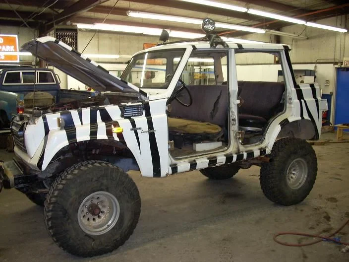

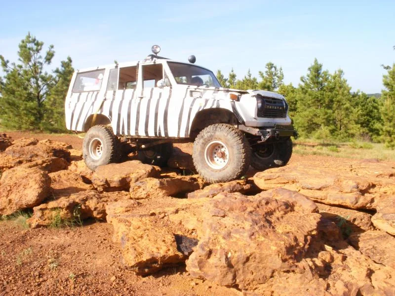

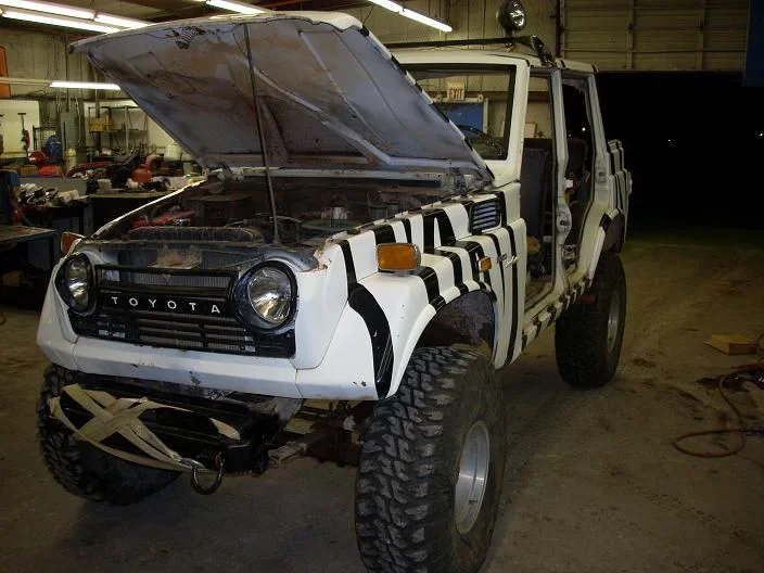

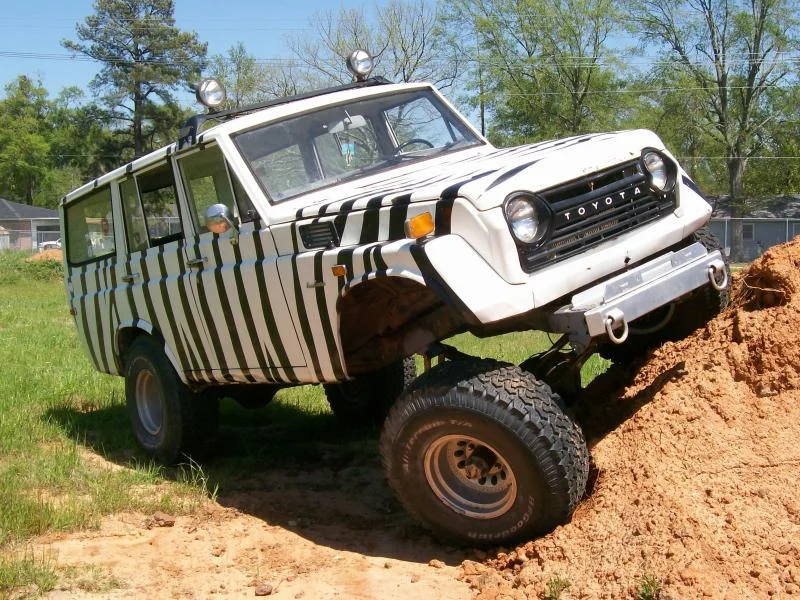

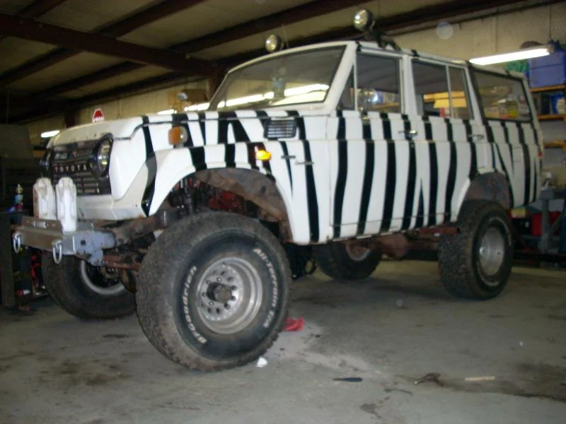

In the Fall of 07’ I tore the whole thing down at once and did shackle reversal, SOA (with C&T), disc brakes, etc. I got a set of 35” BFG A/T’s cheap and threw them on. I took it wheeling once, decided the tires weren’t big enough and got some 37” MT/R’ from CL for 100 a piece. I wheeled the balls off it several times and quickly realized that I need to get geared down. I wheeled it several times with stock gearing and HATE IT but that’s next.

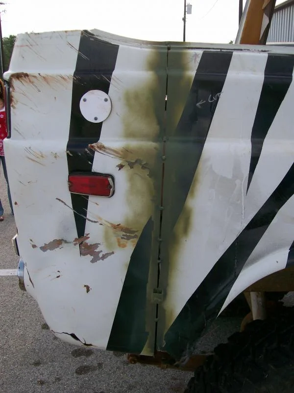

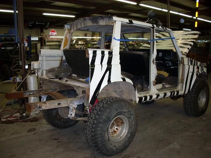

Most recently, I started (not yet completed) the PIG BOB where I took 12.5” out of the body to better the departure angle.
