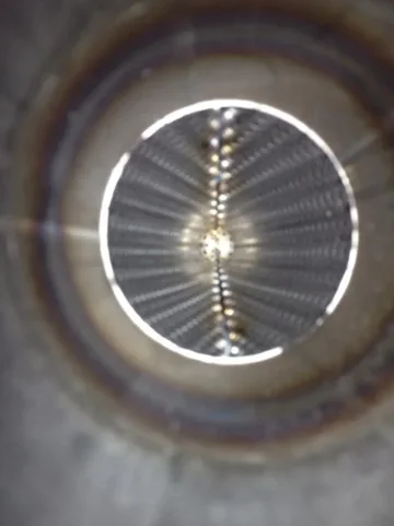

So after driving around with 4.88's I now find my EMS exhaust a bit louder than before. Highway driving especially bad around 3200 rpms. This is not an anti EMS thread, please don't make it one. I did change the aero muffler out for a Magnaflow so that's what I'm running now. As I wasn't sure what I needed I picked up two resonators off of summit. A hushpower http://www.summitracing.com/parts/FLO-12512400/ and a Moroso spiral flow http://www.summitracing.com/parts/MOR-94054/.
Does anyone have experience with either of these? The hushpower has a grate/mesh fill whereas the Moroso has an open center with a spiral/screw like outer shell which splits the exhaust in two. From what I read the Moroso works pretty well but I was looking for some real world experience with either. I would like some sound but the drone has go to go! Thanks for any input you may have,
Hushpower
Moroso

You've spent more on your exhaust than I've spent on two of my trucks. I envy you, rock on. I think th Moroso is pretty good with the drone, Ive used them twice in V8 applications.
I installed a Vibrant resonator in the same spot as you and it helped quite a bit.
But since you have two resonators that you've already bought, and you have to cut the pipe to install either of them, why not just try them both and keep the one you like best?

I took it on the highway with the moroso and the drone is gone, but that could also be attributed to the exhaust dumping down instead of out the side. I havent tried the hushpower on the highway yet, that sucker was too hot so swap during lunch.
So I installed the Moroso tonight, sounds great! I had to expand one end of the resonator for some reason, I thought 2 1/2" inlet to 2 1/2" outlet meant just that. Luckily we have an autoparts store in town that loans tools out:)
My tig welding skills could use some improvement but there's only one way to learn. This is a "good weld"
It did turn out well in the end, every thing fit just like before. Too bad all the decent welds are on the topside...LOL
Anyhow, the drive home from work was a pleasure. The overpass (walled) that usually sounds the loudest was quiet, and off the line it sounds great too. The higher rpms don't reverberate through the cab anymore and that's exactly what I was after. Didn't get a chance to hit the highway yet but I know from the drive home it will be mint. I have a few other sounds clips from before the resonator and I'll post up tomorrow when I get an "after" video.
