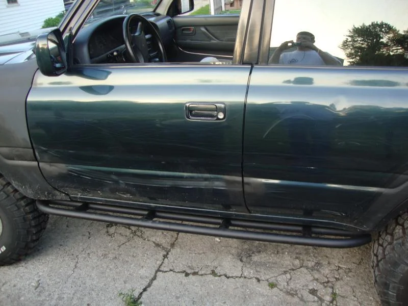

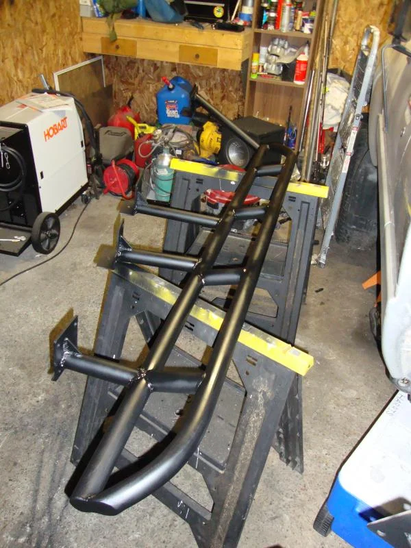

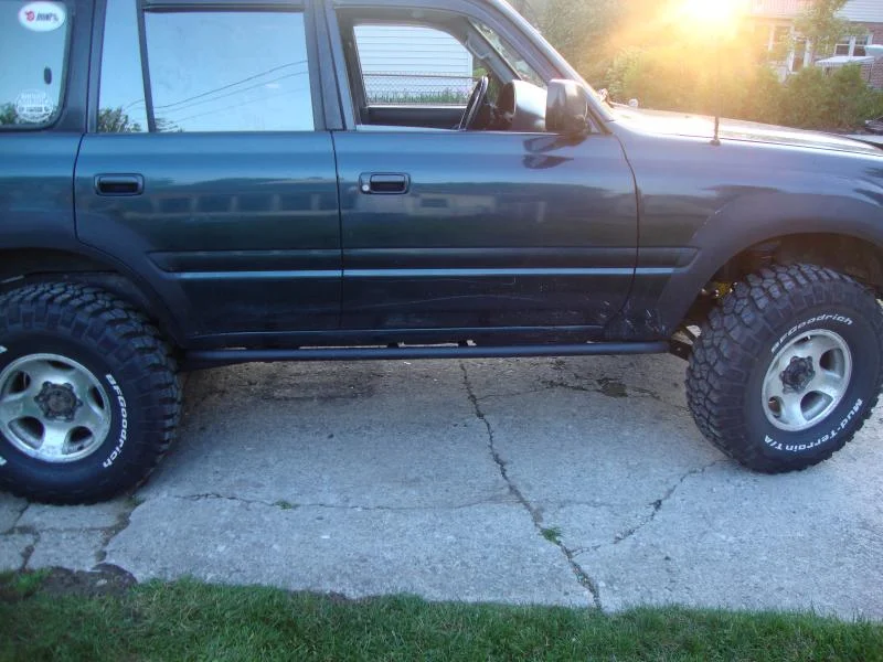

I was actually able to get off work early today, and was able to firm weld the budget sliders for the 80. I hope that I can get them welded on tomorrow. I'll post more pics if I do.

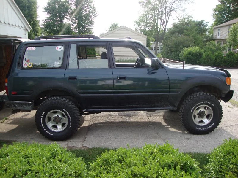

I did get the sliders put in this afternoon. I think they came out alright.

sliders look real good, just have something goofy looking in the rear window.

Yea that tree looks crazy, I'm going to have to cut that thing down.

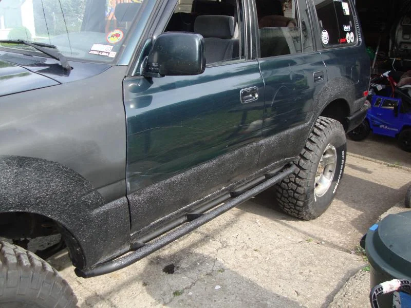

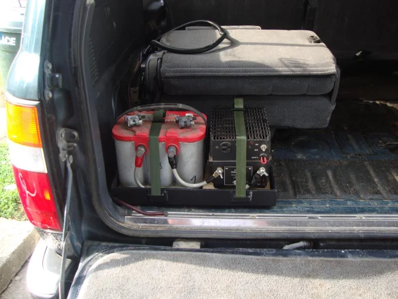

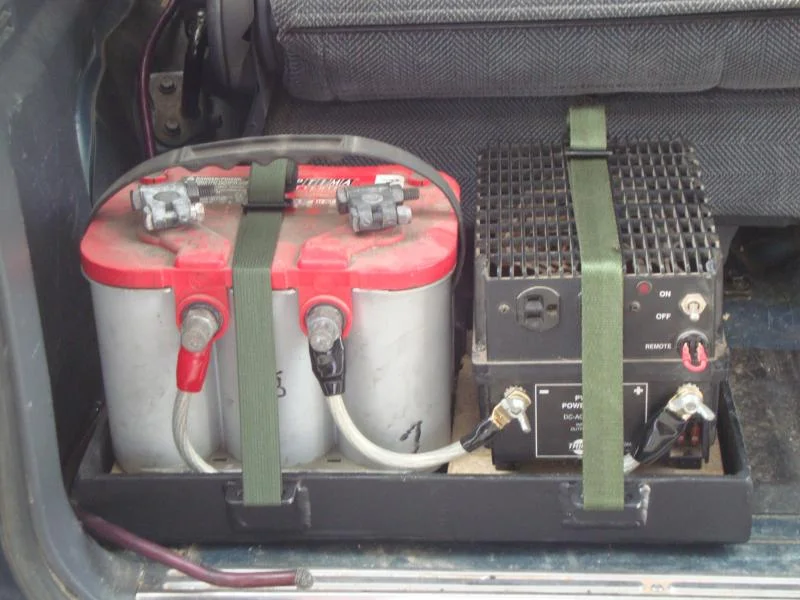

Finally had time to get the Herculiner on this past weekend and then also started to install my inverter. Still need to get the final wiring done before we go to Tennesse. The last picture doesn't really show good detail but thats what I have.

The Herculiner.

I think that it was 70 or 80 bucks and it included everything but rubber gloves and acetone. I only used about half a gallon to do the truck and can now do the bed of the LC if there is such a thing. The kit comes with a gallon and was plenty.
Most of my time was spent measuring my lines and trying to make it look right. I put the Herc liner on as low as possible to let it grow on me and if I want to go higher then I have resereves.
The pictures do not do it justice. It went on easy and well, as long as you follow the directions.
Just a side note, I sanded all the clear coat off the area that I was going to paint and scuffed it pretty well so the Herc would adhere. I taped my lines and then sanded and then retaped.

I only applied two coats with about a half hour in between. Then I only waited an additonal 10 min. before removing the tape. You do not want to wait until it dries or you could run the risk of pulling the liner off before it cures.
