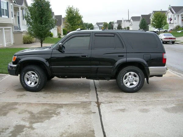

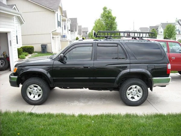

Quote:
Originally Posted by FlatlandTRD View Post
I had to chuckle. So you want us to believe that you saved money by doing it yourself, no one died, and the compressors didn't break shooting the spring through your garage wall as well as five of your neighbors? I think we need some pictures... of the 4rnr of course. Was this for ~2" of lift?
well yes
I did get about 2" of lift maybe a little more in the back
contrary to popular belief no children or small animals were harmed from me using the strut spring compressor
and here are a cople photos
