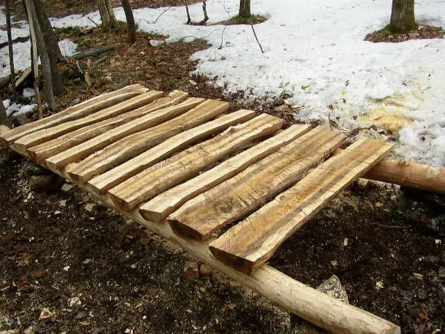

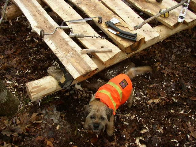

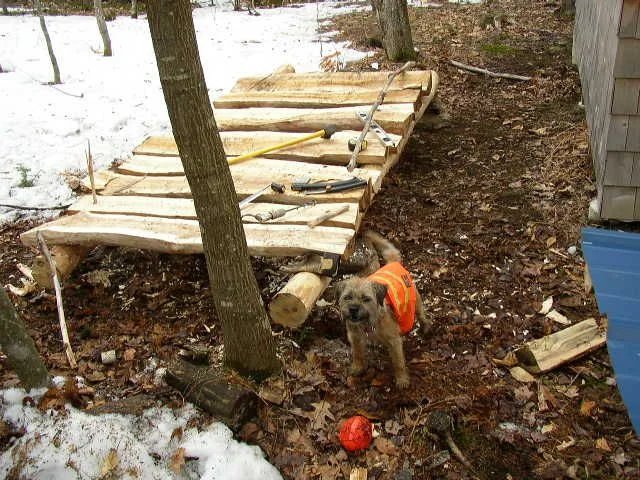

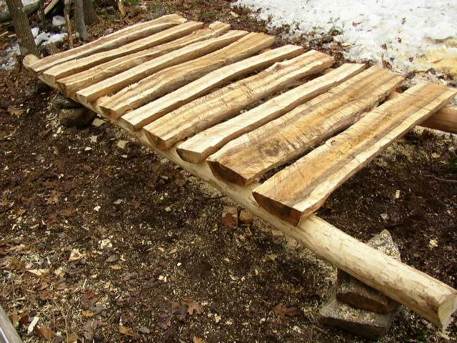

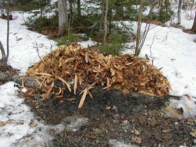

I cut the trees down last week and they are maple. I selected the trees specifically because one was leaning crooked and was going to fall in the future. The other two were taking away sunshine from a beech tree that I would like to grow large, it has some nice lower horizontal branches.
I'm planning to use these to build a firewood shelter in the spring. So I skinned them with a draw knife. Knife is a two cherries and I have it sharpened really nice with a fine diamond stone.
I was surprised at the speed of the tool and stripped these 5 logs in a weekend, in between hiking and throwing the ball for Bean.
I could not move the largest one, so there it lays untill I can lay it up with the others.

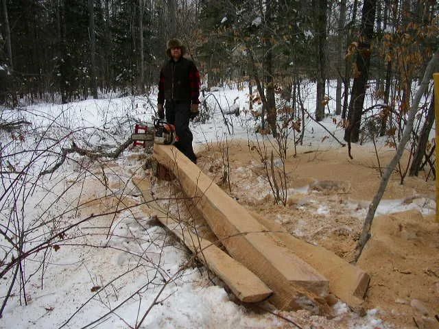

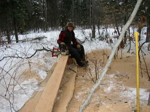

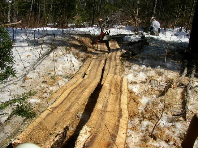

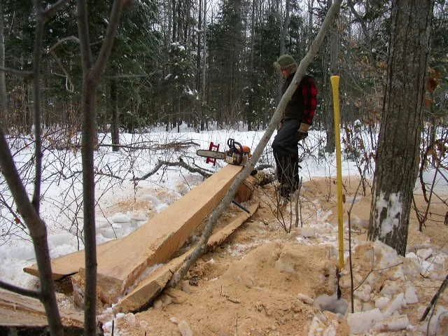

I cut this beam from a cherry standing deadwood.
7.5inch x 7.5inch and 13ft long. There are no branches, so it is a good strong beam. I used the sled to skid it down the hill and stored it under the cabin so it can season.

That beam is really nice. If you don't mind me askin, what kind of jig do you have mounted to the saw, do you use a special cross-cut chain, and how do you get the first cut straight?

Looks similar to this.
Mini Mill, Model# G555B | Saw Milling | Northern Tool + Equipment
Most first straight cuts, the operator uses a 2x6 for a guide.

HUD-SON chainsaw sawmill lumber maker mill
No special chain...I have a Stihl 310. It is still pretty tricky with the guide. Not to mention hard work. But I like it.

That cherry beam is incredible. No knots, wow!

Tree down & split up. Stripped the bark and over with the others.
Notched the logs, planted some rocks.
Used some oak for pegs to draw them together.

Now we have a platform....12ft long x 5ft wide.

I like your little helper
