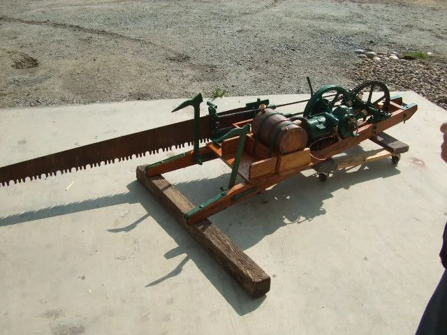

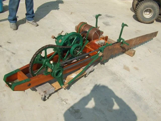

Many of you know that I collect and restore Chain Saws. I currently have 97 of them and over 50 of them run.
I just finished the restoration on my oldest one. I did 90% of the work on it and took it to an "Old Timer" so he could put the finishing touches on it. No disrespect intended by using the term "Old Timer" but he is 97y/o and is a great fabricator.
He found me the correct vintage roller chain that is held together with cotter pins. He found the correct vintage blade. He made the copper fuel tank. I found one that was Galvinized but it was not the correct vintage.
This was built between 1914 and 1920.
It runs great!
Hope you enjoy the pics.

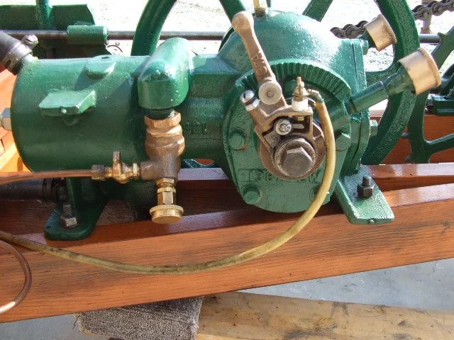

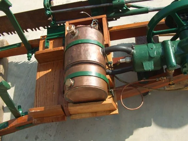

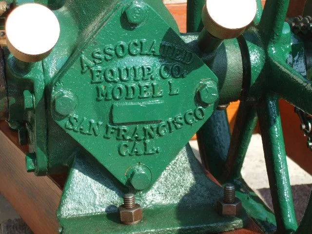

Here are a few close ups.

Officially it is called a Drag Saw.
You cannot use it to fell a tree, just to cut it up.
The big tank is the water tank and the small tank is the fuel tank. They run straight gas but you really have to stay on top of the lubrication. The brass looking things are actually Grease Cups. Every hour or so you give it a 1/8 of a turn and it forces grease down the tube and into the babbit bearings.
