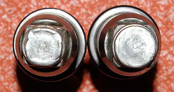

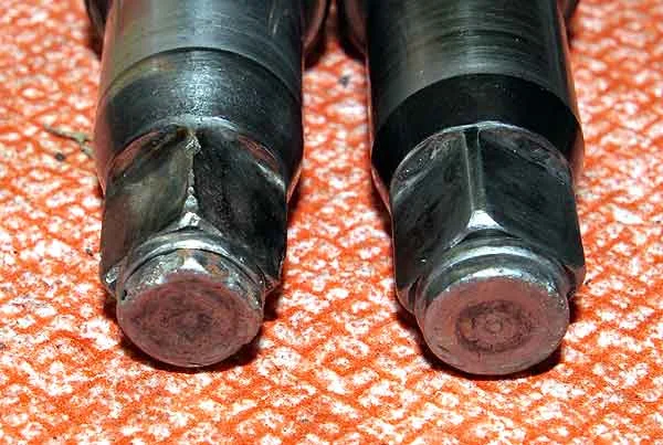

I agree that impact sockets aren't that expensive, my last couple of sets are Grey Pneumatic, good sockets at a great price. But in a pinch it's not that big of a deal to use chrome, however never use any hand/chrome universal joint/sockets on an impact, they can come apart and fling pieces. I carry a IR2115 in my trail kit, the only impact stuff that I carry is a couple of extensions, u-joint and a 21mm 6pt deep for lugs, the rest of the sockets are chrome. The chrome stuff is much less likely to rust and the thinner walls fit more places.
I replaced a 1/2 IR anvil this morning that has chrome wear, the one on the right has normal wear, the one on the left has seen a bunch of chrome use.
it doesn't look that bad. Was is high time to replace it?

Quote:
The customer wanted the tool refurbished to like new. In the pic above, compare the corners, the IR anvil should have flats at the edges, that one is warn so the corners are sharp, causing a bunch of slop when a socket is installed. The ring that holds the socket retainer on is deformed, so that the retainer ring is trapped in place. I could open up the groove on the lathe so the retainer would work, but it's never going to be "right". The slop in the square drive will cause socket wear and the retainer will never work correctly and may come off often. IMHO it's junk.
