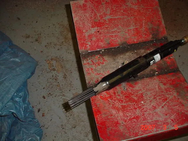

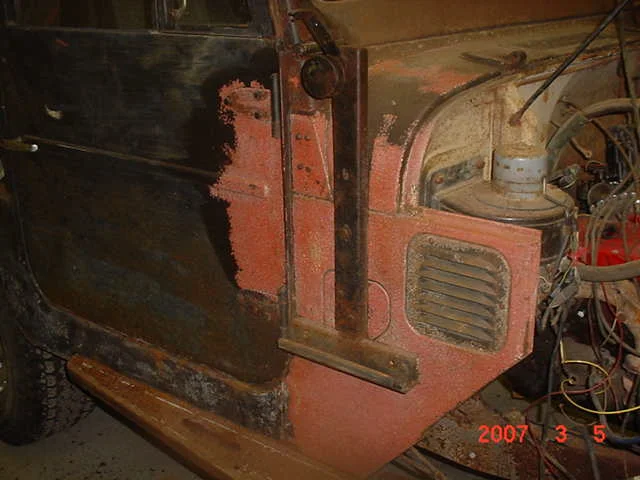

Rust scaler

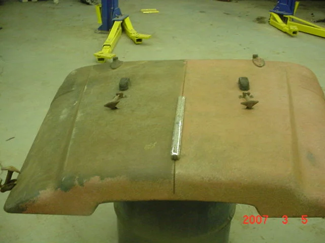

I just got a cool new tool based on some research in how to get rid of old rust and undercoating.
It's called a scaler. It's used a lot in ships to get rid of scaly rust. It's just an air hammer with a bundle of needles - it's also called a needle scaler.
It works really well.
Pic 1 is the scaler
Pic 2 is before
Pic 3 is after about a minute.

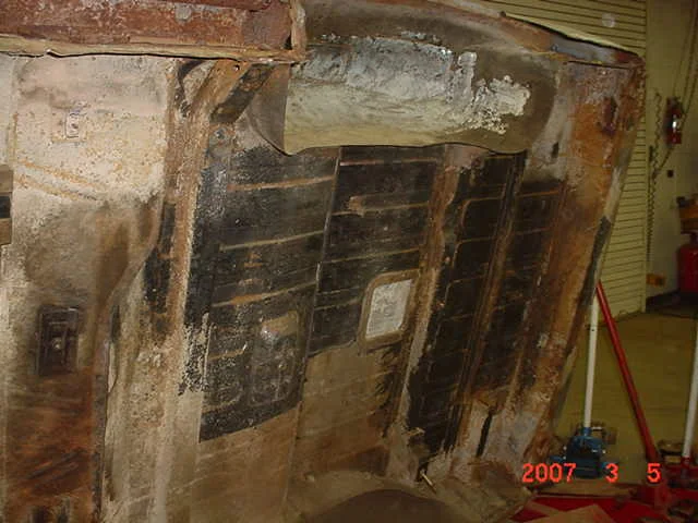

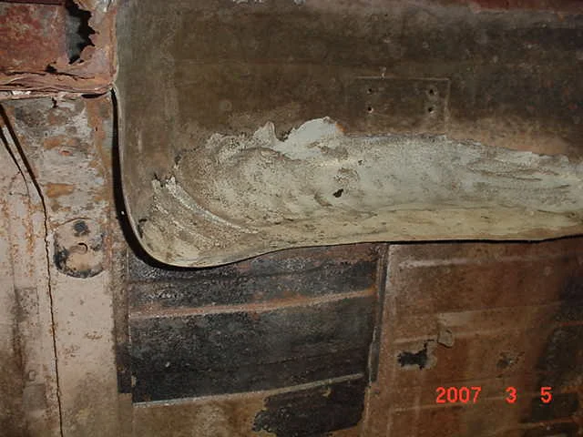

Another couple of minutes on the really thick stuff in the wheel wells. Earmuffs, safety glasses and a particulate mask are a must. It'd really kind of suck without the rotisserie.

Reciprocate. It's really just a fast air hammer.

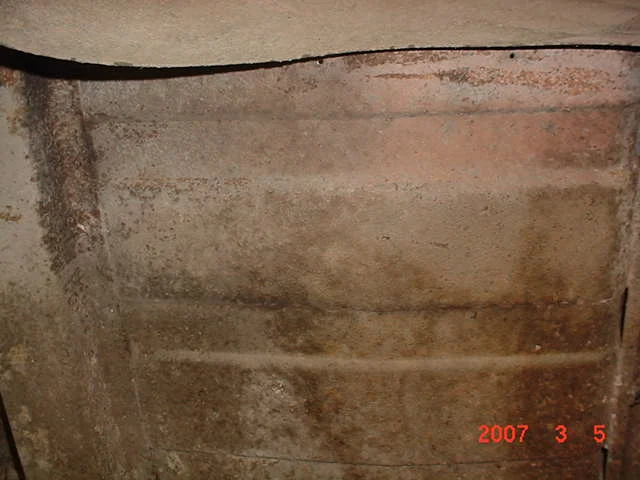

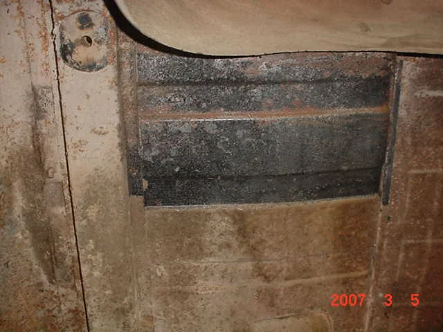

About an hour is all I wanted to do. Doing it all day would suck big time. It's hard to type with tingly fingers.
1 - about 45 minutes on the 55
2 - tried it out on the 40
3 - 20 minutes on the 40 hood. That old 60s enamel just cames right off. The red is primer. 10 minutes with the DA and it was bare metal.

It works better on the thick undercoating at an angle down to about 15 degrees.

That's a great tool, but be careful on sheetmetal, it will ding and warp it.
I have found them to be really usefull on frames.

I was worried about the hood getting warped, but it was an old one for a junker. Anything was better than what it was.
That old 67 sheet metal is thick. It did just fine. I wont be using it on my 55 hood doors or panels. On the underside it's pretty well formed for strength. I haven't had any issues.
The IR scaler is adjustable as well.

It would tear up some cork gasket.
It really won't do a lot on decent paint. I wouldn't anybody going out to get one to take the paint of their truck. It really doesn't do much on the factory paint on the 73 55.

Quote:
Originally Posted by bsevans View Post
What are the air supply requirements; CFM at what PSI?
12 CFM. I can't imagine it would require over 100 psi.

I'm trying to remove the undercoating from a pickup frame I have. The paint/powdercoat underneath the undercoating is in superb shape, and I'd like to keep it that way if possible. Do you think this would be a good tool for that, or would it mess up the paint too?
Thanks,
Ary

Quote:
Thanks,
Ary
It might ding it up a bit. It would give it a hammerite finish if anything.
