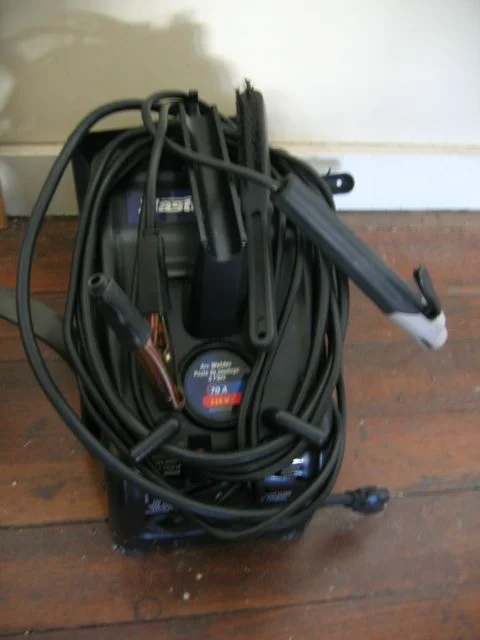

I got a free el'cheapo arc welder today. got a few questions.
it's a 70 amp / 115 mastercraft stick welder (campbell hausfeld rebadge)
1.) can you weld aluminum with this thing?
2.) there are no buttons on this thing except and on/off switch. do you just turn it on and weld... or do you turn it on and then press the knob on the stick holder and then you can weld?
3.) if I read the directions pamphlet right.. if it's 20% duty cycle.. you can weld to 2 minutes and then you have to wait 8 minutes for it cool down then you can weld for another 2 minutes, then wait 8 minutes......

Okay, Welding AL with that would be a serious PITA. Not saying it couldn't be done, but man, it would suck.
Is there another knob on the holder that we don't see?? I am betting turn it on and away you go.
Duty cycles are misleading. try it and find out.

the only switches are on/off, and a low/high. the low high is for a 15a/20a circuit or 1/16" / 5/64" sticks.
yeah it's turn on a go. the only thing on the stick holder is a button that looks like it opens up the stick holders inside the handle.

The button is a lever that opens the jaws of the eletrode holder.
Any welder is better than nothing but that one is gonna be really limited..

Buy a 10 pack of 6013 sticks and try it on some scrap steel. 6013, AKA "the Farmer's Rod" is about the easiest starting and welding stick you can buy and is designed to be used with welders like that and can give a surprisingly good result.
I think it would be a waste of money to try to use it in aluminum.
no.
to stick AL you need a DC machine.
i really doubt your 110v machine is an ac/dc welder.
for 3/32 al rods you need 50-90 amps, your old 70amp machine probably is going to be way cold for anything but soda cans.
stick welding AL is a pain in the ass under the very best conditions.
i've done it once myself, just say i've done it. i have had to fix other peoples attemps at aluminum repairs after thay took the stick to it. which is an even bigger pain in teh ass.

You can use a Scratch start tig torch with a stick welder on AC mode. But with that welder you are basically wasting your time.
yeah, without a pulser or the constant high freq, that will be a BIG waste of time.
