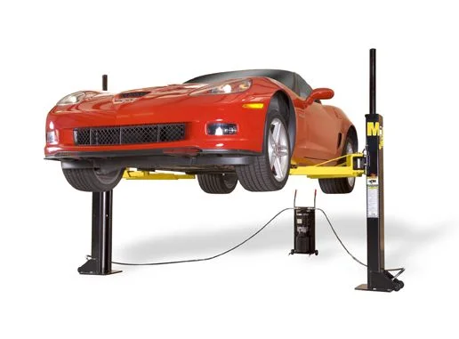

Hi - does anyone have any experience or opinions on this Danmar auto lift for garages with low ceilings? Danmar MaxJax Lift

Interesting idea, but I'm wondering about the maximum lift height of only 52". The frame on my pickup is already 23.5" above the floor, so in my case I'd only get about 28" of lift out of it before I'd be at the max height. That would be great for doing stuff like brakes and knuckle jobs, but not so much for working underneath, dropping a tranny, etc. Not sure it's worth the effort and expense.

Regardless, I don't see you or me in a red 'vette .
Good point on the lift height. It would be great for wheel swaps, brake work, tranny swaps, pulling body of frame, and getting under the rig on a rolling stool rather than a creeper. Might be worth it for someone that maintains multiple vehicles or is into a restoration.

I'd save a grand and buy something like this lift:
Master Series XL-9BP Base Plate Two Post Lift - Greg Smith Equipment Sales, Inc
My uncle has a similar Rotary brand lift in his shop. Works well. Yes, the piece across the floor can sometimes be a PITA but we never let it stop us from getting stuff done. IMHO almost any lift is better than crawling around on the floor trying to work on a vehicle; even a 4 post drive on lift (my brother has one of those...).
Or buy a used Rotary, Mohawk, Bend Pack or other pro grade lift. There's usually several used lifts on Craigslist and Ebay...

A friend just bought the PV10 model from Greg Smith
http://www.gregsmithequipment.com/Atlas-PV-10-p/tppro-pv10.htm
We installed it in his shop. This was bigger than what you are looking for, but they have prices marked down on all the models so the time may be right.
Also, self installation was not as big of a chore as you might think. Lifting the posts upright was the only real challenge (we used a winch rather than just should power as the instructions indicated).

2X on Greg Smith Equipment. I got an Atlas Nine last year and I love it. Plus if you feel like a road trip to Delaware it will fit in a pickup and there is no sales tax in Delaware.

Get a 4 post lift with Casters. You can wheel it outside on nice days and use it inside as a low lift for days you can't work outside.
I used to have one and it was great.
2nd idea. Check out the AC jacks and jackstands that Pelican parts sell. Super high light jacks and very tall stands. Clearly not as convienent and not cheap, but cheaper than any lift.
