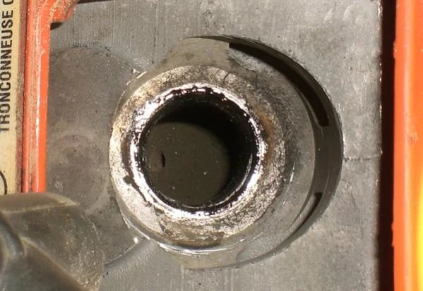

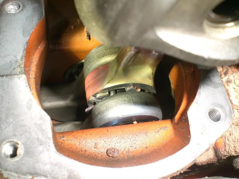

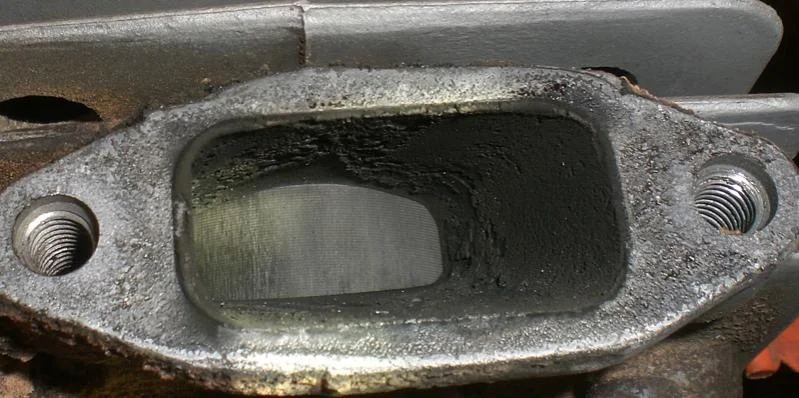

Picture of the piston through the exhaust, and through the plug hole. Nothing horrible from what I can see...
The saw started as easily this time as it ever has - and I'm wondering if I actually do have a hole in the tank, as I fueled it up last time I used it, just before I quit, but this time the tank was almost empty before I started (though the chain oil was no where near empty)
Can't push the piston down through the spark plug hole.

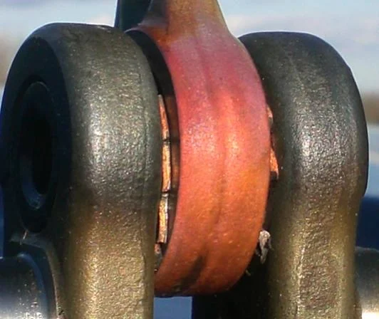

Pulled the pull start off and it was stuck, but that wasn't the problem. Once I removed the pull start I could move the flywheel, but couldn't make a rotation.

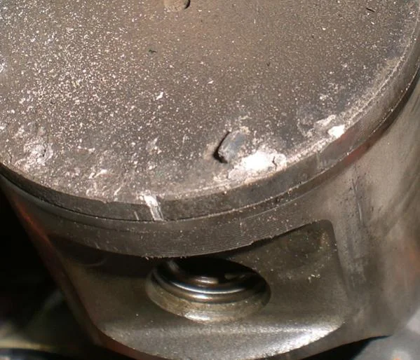

Pulled the head. Found a nice small chunk of steel sitting on top of the piston, which appears to have been bouncing around for a few strokes. No damage to the cylinder walls, just the top (which I assume is no problem)
So, thinking that maybe somehow this had stalled it I got happy for a few seconds, thinking just pull it out, put it back together and ta-da.. then I thought... but where did it come from??
It wasn't from the spark plug. It wasn't from the ring. Hmmm. Tried turning the flywheel over while supporting the piston. Crunch... grind... Um... yikes.

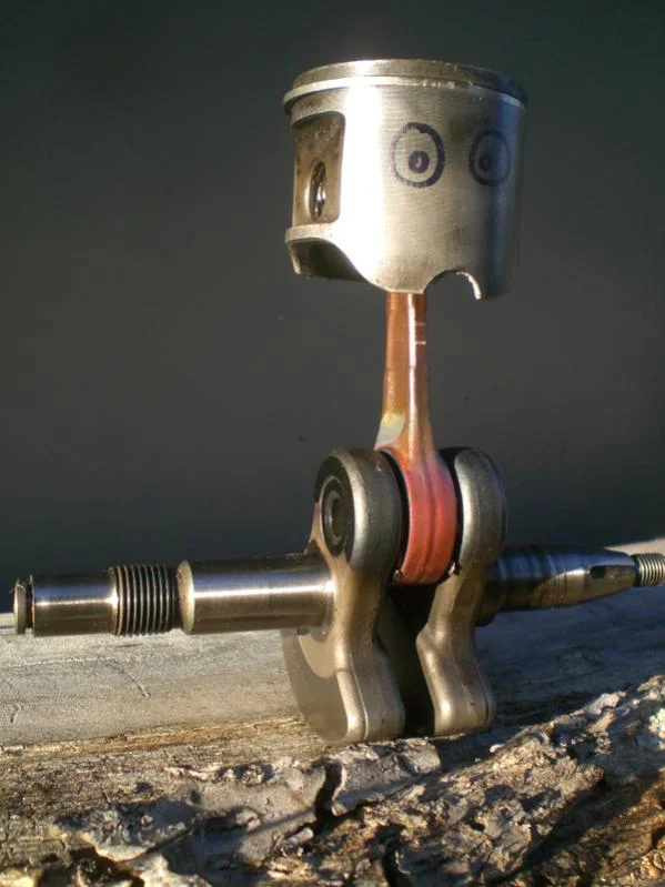

Looks like I shredded a bearing between the con-rod and crank. Not exactly sure how to proceed from here!!
Is this something that just happens after a while? is it a faulty part? or is it something that could have been prevented?

Your lower rod bearing is bad. You have to replace the crankshaft.

That bearing is a non replaceable part. It comes inside of a new crankshaft.

I'll take another picture of the con rod once it's out. it's got some cool colors on it!

3 shoe... got it off. (it's kind of like asking for a tracking number, as soon as you ask, it arrives)
Made a tool from a piece of pipe.
Hammered the snot out of the rest of it and it's now apart... Have a new pet named "Cranky"
Natural color.... nothing added. (except heat!)

Looks like your piston skirt is broke.

Notice how the crank eccentric at the lower rod bearing has gotten so hot it is blue/almost black. That is from the heat generatred from that bearing going bad.
It should be a copper color from the factory heat treating process. They heat treat the entire crankshaft but do not heat trest the entire crankshaft that way since it would make the crank too brittle.

Why does your crankshaft look veeery dry? Maybe lack of oil is a reason for the seized bearing?
BTW: Husqvarna kick stihl's ass everyday. Usually, in sweden anyway, they say that you should replace your saw when the piston starts to wear. After that all the major costs come...

Excessive Heat cooked the oil off of the crankshaft.

Yeah, I broke the piston skirt - stupid mistake but with the damage on the top I decided it needed to be replaced anyway...
