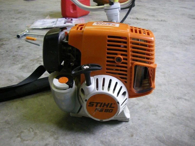

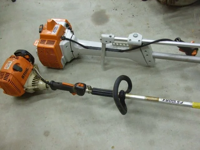

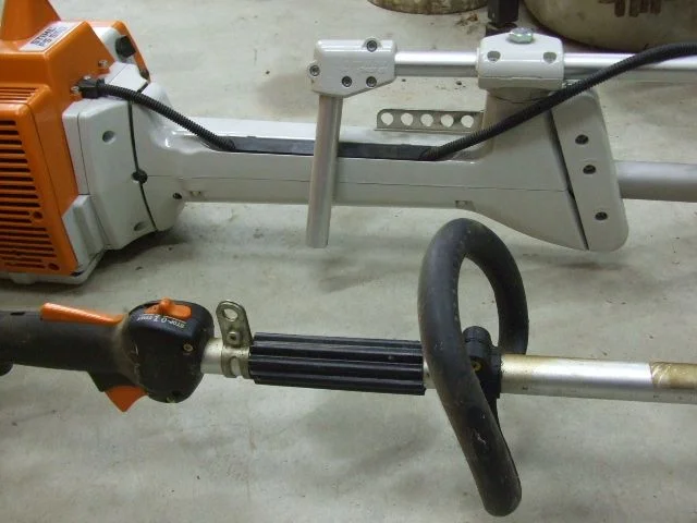

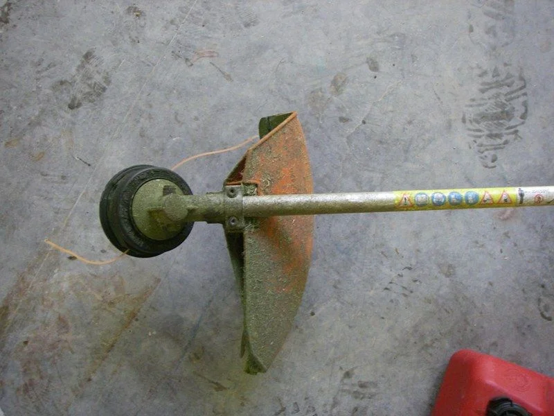

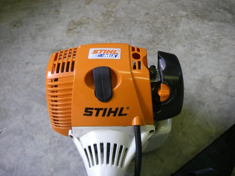

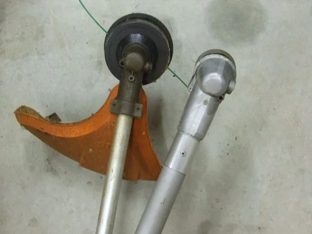

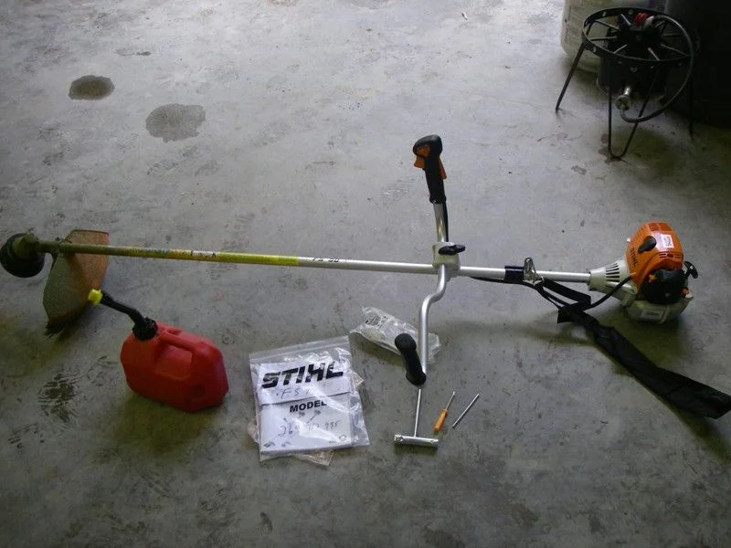

Extreme Comparison
The shaft in an FS 90 is a solid Steel drive shaft. The SRM 2100 is a cable drive. The outer tube of the SRM 2100 is 22mm, the STIHL is a 25mm.
Here is a picture comparison of the FS 90/100/110/130 next to the FS 550.
The engine on the FS 550 is 3.75hp. If it were a chain saw, it would handle a 24" bar pretty easy.
The handle bar mount on the FS 550 is Anti-Vibration mounted and Uber Heavy Duty.
The drive tube is massive as well as the gearbox.
I am not recommending you buy one. If you cleared saplings for a living, then yes you need one.

Dang, the FS550 really dwarfs the FS110 in those pics.
So the FS90 would be a significantly tougher unit than the Echo. Although I'd love to have the FS550, I really only need a FS90/110/130??? Thanks for your recommendations, Dan!!!!
