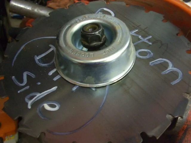

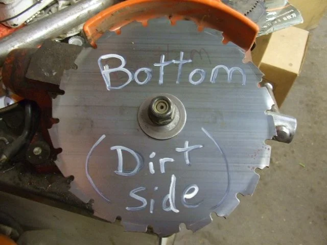

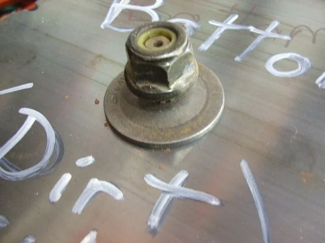

Here is THE setup for your needs.
I wrote Bottom (Dirt Side) on the blade since 90% of the people get it wrong the first time.
The bottom picture shows the Anti Scalp dish. It protects the nut more than anything but it is designed to glide along the ground.

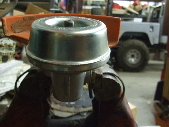

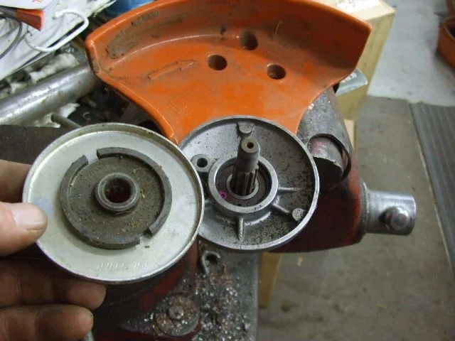

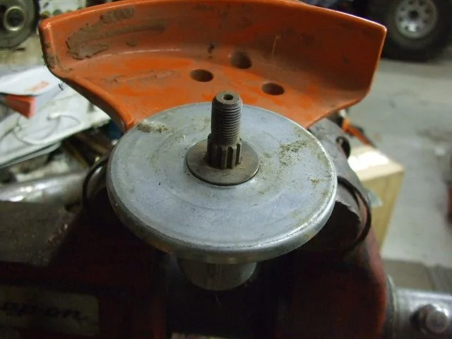

Here is the assembly sequence.
You already have the washer. It is located between the 25-2 bump head you have on the unit now and the gearbox.
A pin slides through the hole on the side of the gear box and lock into one of the two detents in the washer. You head will unscrew to the right (backwards thread).
You will replace the deflector that you have now with the aluminum Limit stop. You will remove the four screws holding your guard on and re-use three of the screws. The limit stop prevents sapling from getting lodged between the blade and the deflector.

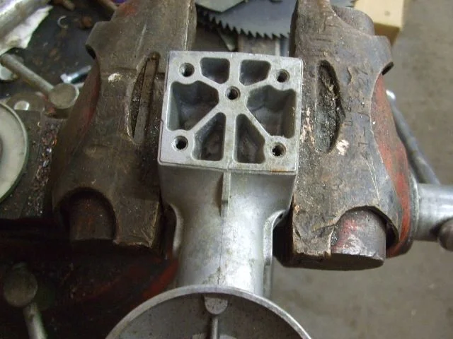

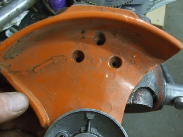

The Anti-Scalp dish does not limit cutting diameter.
It has the same O.D. as the wash and gearbox.
The bottom picture is the bolt pattern in your gear box in the area of the deflector.

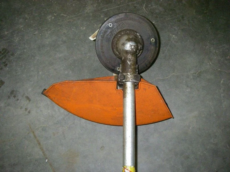

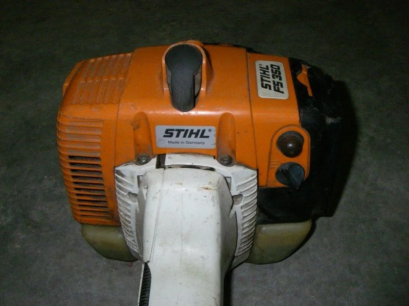

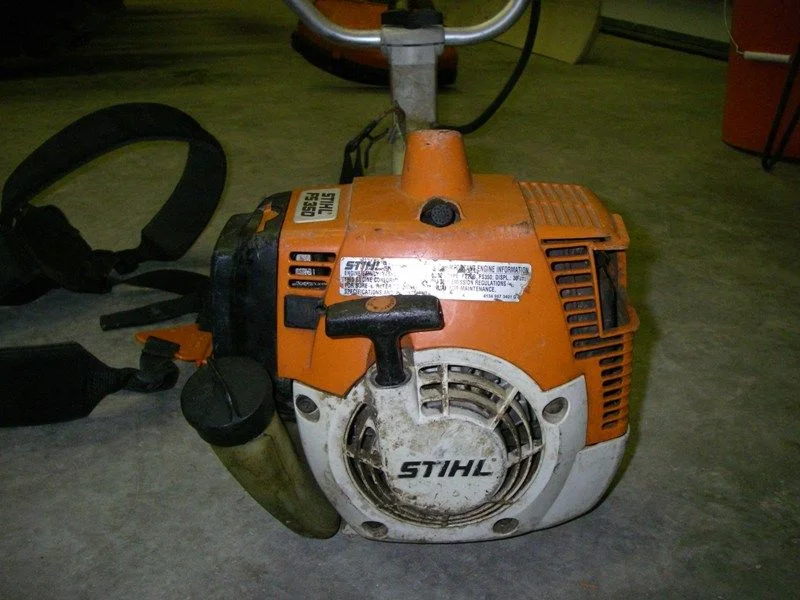

Picked up the FS350 last night. Very impressed already. It runs like a banshee. I can't wait to cut some stuff down with it!!!! I gave him $140 for the unit and already bought a new air filter, fuel filter, and spark plug for $17. I think it's a pretty good dealio....

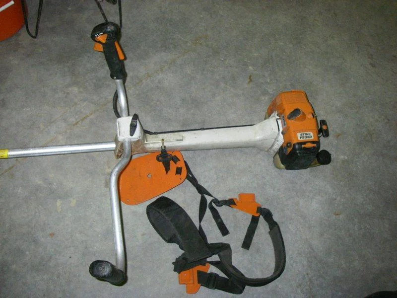

The harness is actually comfy, too....

A question for you Dan........why switch to the loop handle for the string trimmer head on the FS90?
If you are going to use it as a dedcated line trimmer, it is way easier to get around things.
You know how it works with the Bike handles. Switch it to loop handle and try it out. Takes about 11 minuntes to swap them. (45 minutes your first time though. )

Put the metal blade on it that I have pictured. If sharp, it will cut 2" saplings as fast as you can move it to and fro.

Copy, will try it out. 45 mins??? Maybe for Liam....
On another note, I attempted to put the new guard and blade you sent me onto the FS350 quickly last night. Mine must be an older model, because it didn't have the holes in the washer to lock the head, it has a hole in the top of the polycut head to lock it and spin off the nut. I hit a small snag when I found a bolt sheared off in one of the guard holes. Gotta clear that out prior to finishing my install. I don't think I really want to risk it with only 2 bolts holding the guard on.

The hole is in the top of the gearbox. The pin will lock into the slotted washer inside or under the head. You cannot see it when assembled. The washer I posted is the underside of the washer and you can see the "U" shape detents that the pin locks into.
You can use 4 bolts or three bolts on the limit stop (deflector I sent you). The first two bolts nearest the gear box will always be used. There is a 3rd bolt in the center of the limit stop and there should be one in the center of the gear box in the middle of the 4 mounting bolts.
This is all from memory but I did stay at a Holiday Inn last night. I will be home for a short period tonight so i can get pics if you want.
LOL
Gotcha, it's exactly as you described. It's the hole in the center of the gear box (in the middle of the 4 mounting bolts) that has the sheared bolt in it. The other 4 are clear. That mounting hole is used for the limit stop you sent me, so all 3 bolts should be in place for safety reasons. Correct me if I'm wrong. I'll try to extract the sheared bolt this weekend.

HAPPY DAY!!!!!!!! What I thought was a sheared bolt in the mounting hole, was actually just packed in dirt!!!!
After installing the new air filter and spark plug, it's still running kind of sluggish (for what I expected), so tomorrow, I'm dumping the fuel, installing the new fuel filter, and testing with new fuel.
Dan, thanks for the extra blades, I'm gonna send back the two 9" blades and some of the other stuff with the 020.
