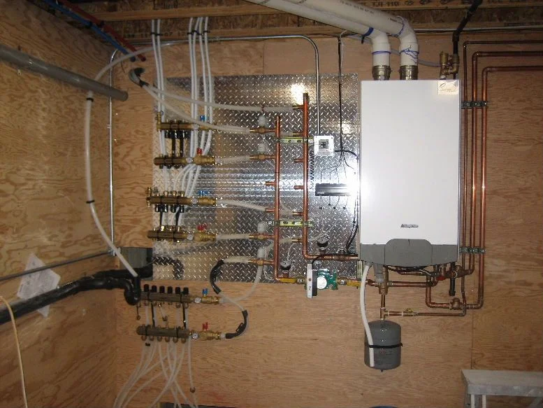

Couple of ?? What type of floor joist? Exactly what type of finished tile? How hot is your boiler output currently? Is it cast iron? What brand of PEX are you planning to use? You will need oxygen barrier tubing and the pex-al-pex stuff is much nicer to work with because it keeps its shape. It would be a little work but you will probably be fine with the router and sleeper method. I would also suggest looking into a product called Ditra from Schluter systems that I used rather than hardibacker. You can save some height that I ultimately needed for the dishwasher to fit and the floor transition is much nicer w/o the hardi
The absolute best forum for your questions is heatinghelp.com and then click on "The Wall"
I think you will need a tempering valve to lower the floor temp and probably and additional circ pump and t-stat for that room. I did not use any slab or floor sensors and have found that the system responds just fine, maybe there is a benefit but I cannot tell. I have been very happy with Uponor products. There are dual sensor t-stats that use a combination of floor and air sensors and Tekmar makes Uponor's electronics and are pulse modulating to better control radiant heat systems. A single t-stat running a pump relay to a Grundfos 15-58 circ should handle your needs easily.
You may run into problems of returning too cold of water to the cast iron boiler and risk temp shocking the unit. You may also be able to use an injection type mixing system rather than a dedicated circ pump. Grunfos has some excellent literature and Wilo makes a very cool ECM circ pump but you should be able to get by with a very simple dedicated pump.
Good luck - here's a shot of my system that i installed, it's pretty easy once you decide to jump in and get to work.

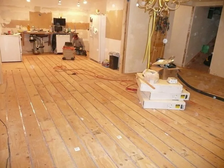

I'm making slow progress on the radiant. My father and I installed all the sleepers during the last week and last night ran the three 250' loops. It actually looks really good. I will hook all the loops up tot the manifolds thrusday night and then we'll start laying the 4x8 sheets of 1/2" CBU.
