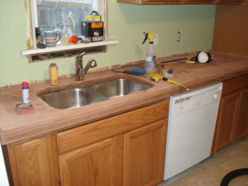

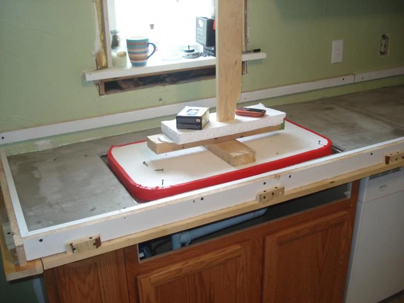

Concrete Countertop
I agree about the substrate. I used some 1/2 concrete board and then metal mesh to make sure all was good.
One thing to think about is how you are going to polish it. I poured in place and had to polish there, bad idea. It turned out great but i got water everywhere, I even had the grinder with the vacuum attachment but it didn't help. Here is a pic of the finished product before polishing and one of the mold.
My overall pour was about 2" thick in middle and 3" at edges.
