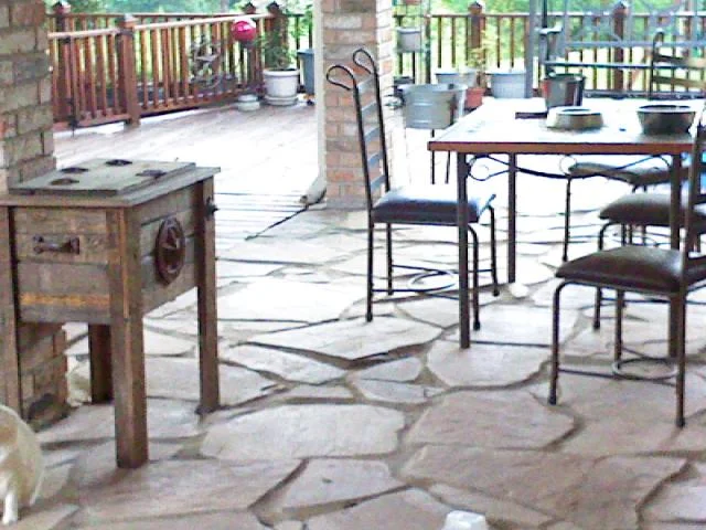

I had a plain concrete patio 2 years ago. I shot a crappy cell pic. I used flagstone and plain mortar and did this.....
I have been very happy with it (and the deck we did later).
No cracking. Holding up fine. However, the winters here are very mild with not many days below freezing and no days below zero.

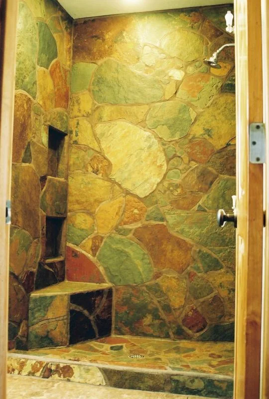

You can cut slate to give the flagstone appearance also.
Did that for a shower.

man I bet that was fun to grout.
__________________
I'm on the boat mofo...
Stay frosty......
fsusteve is online now   Reply With Quote
Old 07-02-09, 07:03 PM   #14 (permalink)
What's next?
splitshot's Avatar
Join Date: Nov 2006
Location: Podunk, Arizona
Posts: 2,501
After the halfway point, I had to step away from it for a week (would have been longer if it wasn't for the Mrs).

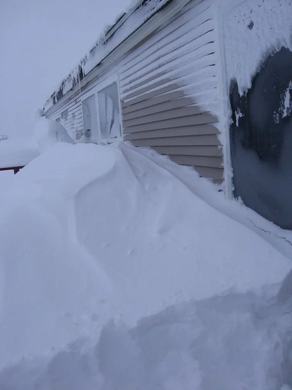

I wish I had a heated deck. Mines 16x24

Wow, no wonder you were jones'n for Havasu.
