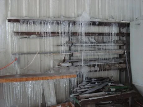

You know, we usually get more snow than you do, but it sounds like you guys have more than we do. We have about 20" on the ground right now and it hit 45 degrees today, so it's a mess. Here's a shot of the scrap steel pile on the side of my dad's shop, under a huge carport. I took this shot this morning when I went out there to use the sand blaster. It's never leaked in 14 years.
