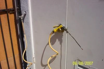

a cheap alternative to a steam cleaner.
Put a hose bib on the hot side of your household water heater. Purchase a hose designed to handle hot water. Use a Plastic Pistol Nozzle with a threaded end (usually used for garden attachments) Put together a Female hose bib adaptor to 3/8 to 1/4 IP and use an old brake line and fitting. Put everything together and you get a pinpoint spray of hot water that cleans off just about anything. Oh the reason to use a plastic pistolgrip spray is it doesn't get hot. Brass or any type of metal and you can't hold on the the sprayer
