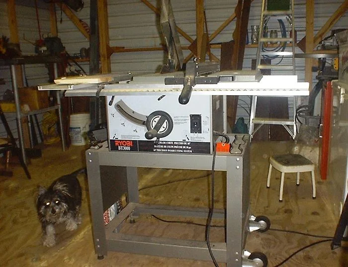

I've had several saws over the years... but this is the best for the $$... it's so smooth running
