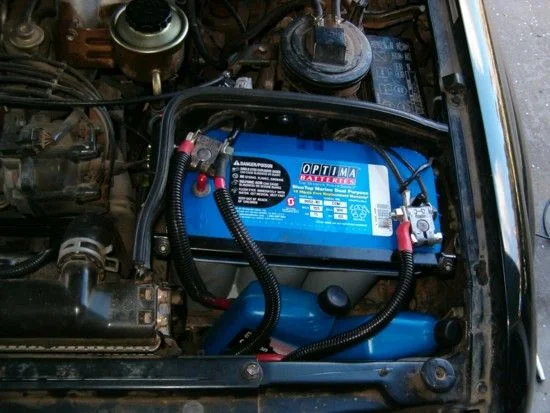

One really good deep cycle/dual purpose will work for most winching. An Optima D31M will fit (barely) and provides many amp hours of power. As long as you are not winching ten trucks up a long grade, it should be fine. I had a winch and one battery in my 80 for 2 years and only recently installed a second battery set-up. While I can use it to winch, the second battery is mainly there if I draw down my main battery with the fridge, or leaving a light on. If you want redundancy, you could always put a battery box in the rear-Hltopper posted some pics of that set up before and that looked pretty good. A dual battery is a piece of mind thing, and a fun project. Like most mods it isn't completely necessary (don't tell my wife!).
The thing about a winch is, that you rarely get to use it, though I did break mine out in Moab to help flip dieselbigot right side up. Try it with a single battery and if you run into problems, then upgrade your system. You may find it is easier to switch to military battery terminals. It makes bolting the winch cables down much easier.
Here is a pic of my D31M with military terminals:
Ok that is slick. Couple questions,
Where to get the military terminals?
What is your review of the D31M (blue top?) I see it has extra mini posts for accessories.
Is the fridge a serious draw on a standard battery? I thought fridges like Engel & ARB were very low draw so assuming you dont have alot of extra accessories, will the stock batt be well within range?

Military terminals can be had at the Napa Warehouse near me. They are also sold by Wrangler Power Products. The Napa ones are cheaper.
The fridge will work with a regular battery, but standard starting batteries do not like to partially discharge and then charge back up. They die prematurely, though in reality it isnt a big deal. A standard battery holds about 50 amp hours of power. The max draw of an arb/Engle fridge is 2.7 amps. Theoretically, you could drain a battery in 20 hours or so. Real world, it takes 2 days to fully drain a battery if you don't run the car at all (beanz2 did the experiment at Rubicon last year and had to give away his ice cream at Buck Island). The D31M is a 75 amp hour battery, and is not damaged by deep cycling. I run a single D34M in my FJ40 no problems.

Pre-release photo
Just a quick snap. My photography skills aren't so good.
Scott
