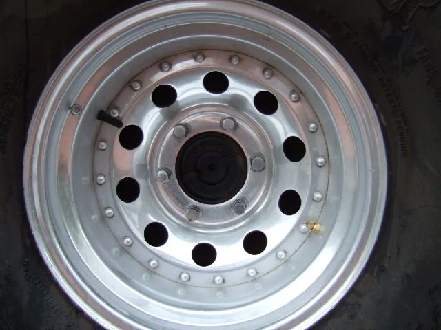

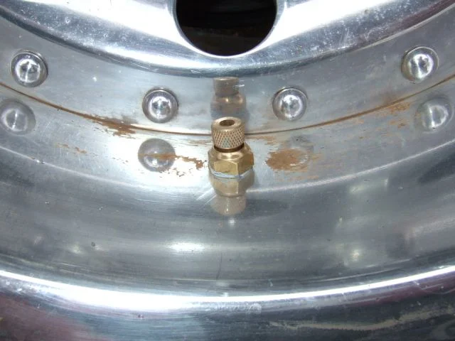

  • 4 Husky Compressor drain cocks (Home Depot) - $13
PN:
HUSKY
1/4 In. Drain Cock
Model HDA71000AV
Store SKU # 826047
Internet # 169706
Catalog # 100095680
Drill a 7/16" hole, and Tap with a ¼” NPT tap.
Now you have a thumb screw drain cock to air down while monitoring tire pressure on the valve stem. Works fast, works sweet, and does not break the bank.

nice!
rebalance, I assume?

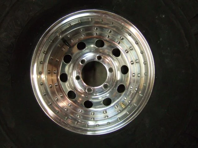

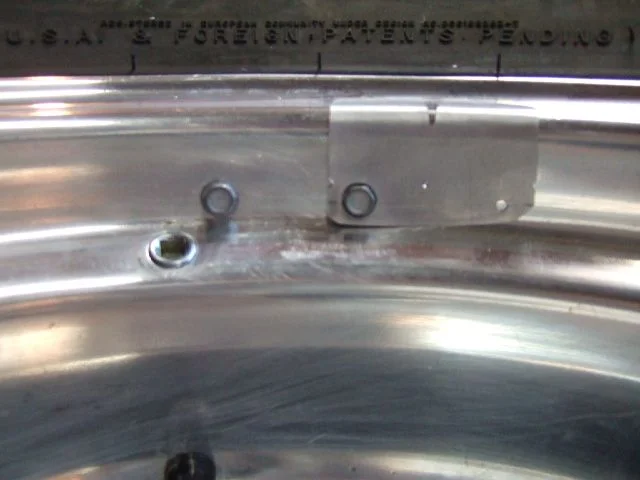

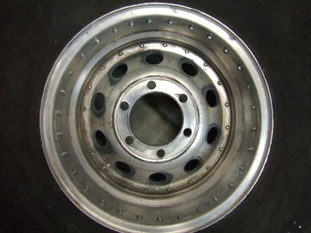

Quote:
Originally Posted by e9999 View Post
nice!
Depends. I did it before I balanced. They don't weigh much. I'd run it and see how it felt
I balanced after i added the Inchworm double beadlock screws. poured the exact weight in bb's in the drain cock hole the balancer called for, Worked like a charm.
For less than $200 i had a set of 4 15x10 double beadlocks with a trick air down system.
Hardware stores are full of cheep tricks

I like the idea. It wouldn't work so well with internal bead locks though.

kinda a cool idea
