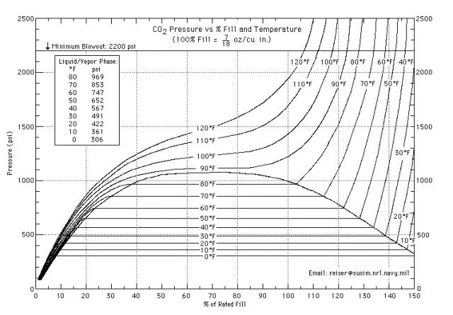

Shouldn't be a problem, depending on climate conditions where it's stored. IIRC industrial type cylinders are tested at 4000psi and CO2 burst disks are 3000psi. Most regulator manufactures don't recommend using them with CO2 temps over 120F.
CO2 tank pressure changes with temp, much more so at high temps. IIRC the number is ~150F where the burst disk is likely to go. That is the liquid CO2 temp, so a black cylinder in the sun in desert conditions is easily at risk, have measured 160F in cars setting in the sun here. Know of two that have gone off in cars here.
That said, even if you travel in high temps, your only risking a fill and burst disk. If you have a burst disk failure, get away the gas stream blowing out will freeze burn skin and can crack plastics, etc, so best to mount the cylinder so the disk outlet is pointing towards open area.
This chart is for paint ball cylinders, 2200psi burst disk.
