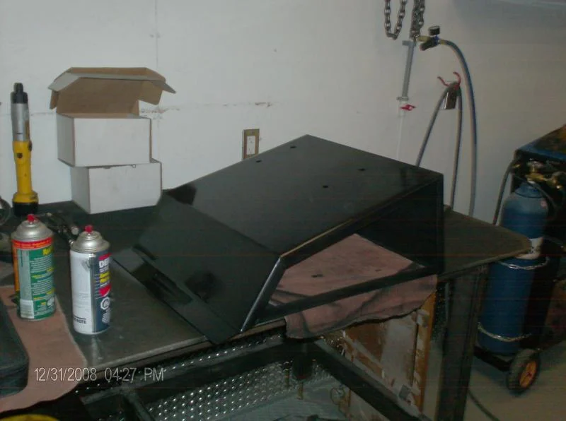

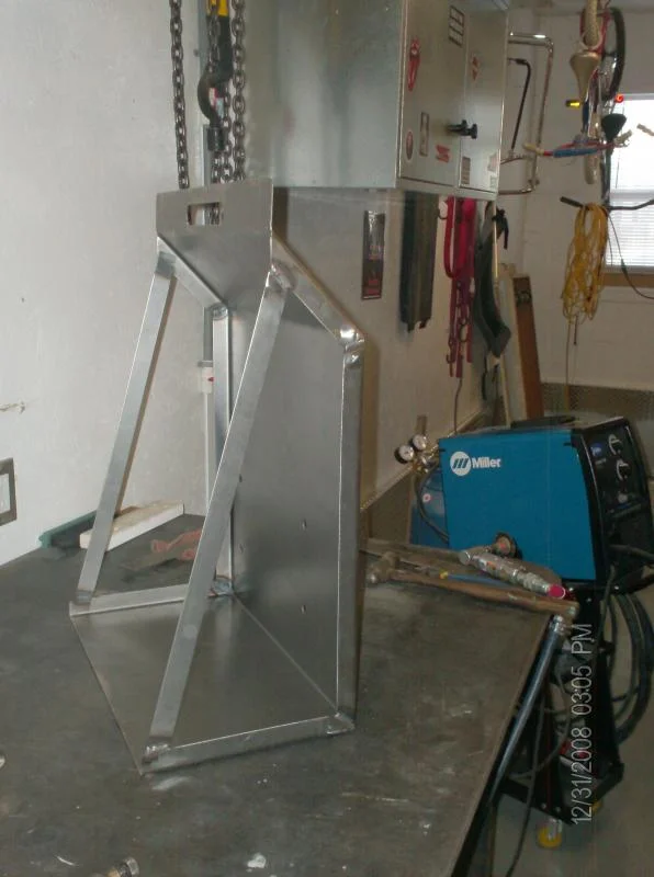

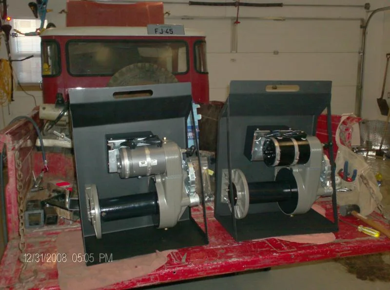

So at work yesterday I made up a couple of quick storage brackets for these guys. Any of you who have handled and moved these 8274's around knows how heavy and awkward they are. These brackets will protect them and me.
Welded corners and strap at home.
A quick coat of black primer for corrosion.

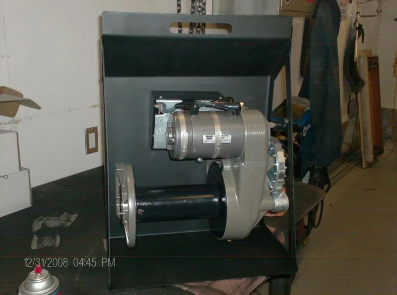

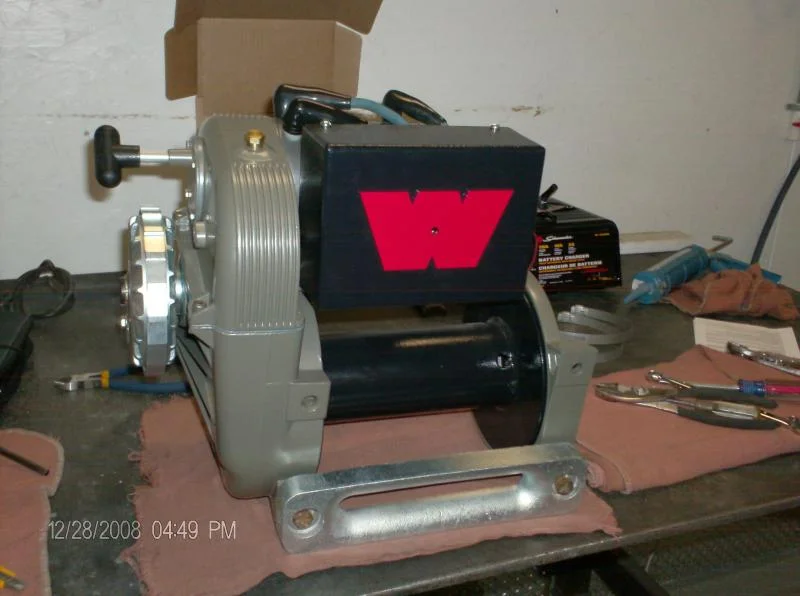

And throw in a winch (oy my back!)

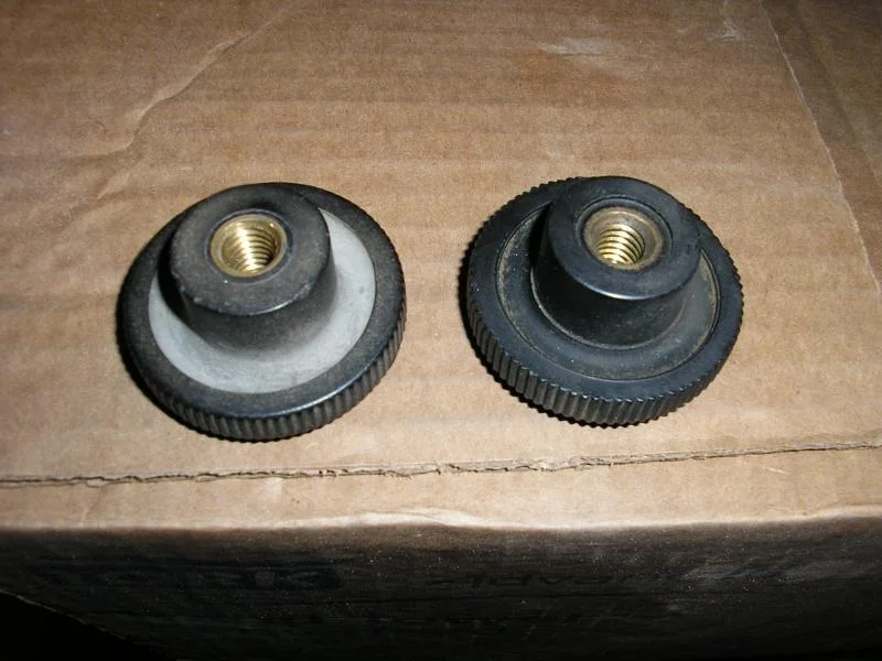

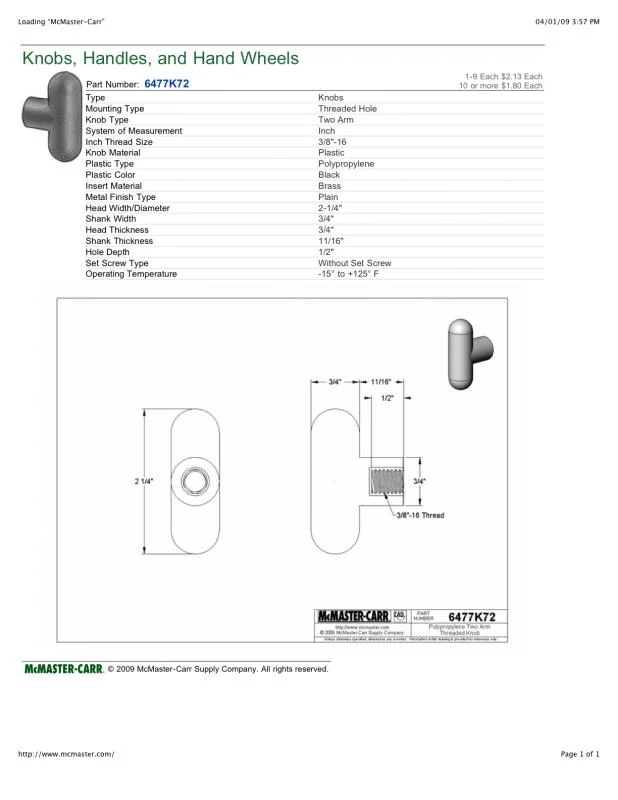

Very high praise indeed. I have read Rezarf's trailer thread and it is awesome. Here is the knob spec sheet from McMaster Carr.
