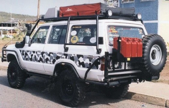

I want those rims
I know this its not the classifieds forum,but here its where more people came to look. I want to buy 5 rims in 16 ¨ better, or 15,but will prefer 16. Pm with price
Plain steelies for my fj60,no tires just rims email me please.

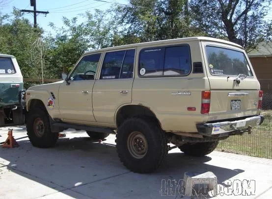

It's cool to see another pic of my rig prior to my owning it. That first pic of the tan one is Ingrid while Ige still owned it. Never saw it with those rims on before. here is an updated photo.
With the rear wheel well rust repaired.
