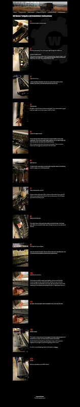

I finally have a set of instructions for the 80s!
Worked my way around to a semi local 80 series tailgate sale (I'm in the wrong part of the country for this stuff) so my friend Rami drove up here last weekend to let me cut a hole in his LX. (what a guy)
I've put the pics in a web page and linked them off the tailgate page on my site, lets see if I can img link them here:

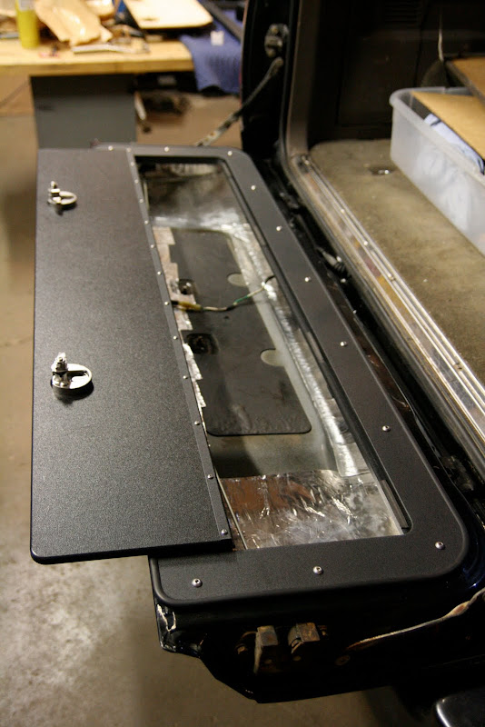

Here you can see the lid sitting on the now cut open tailgate.

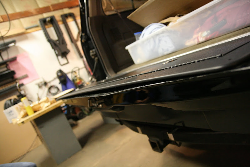

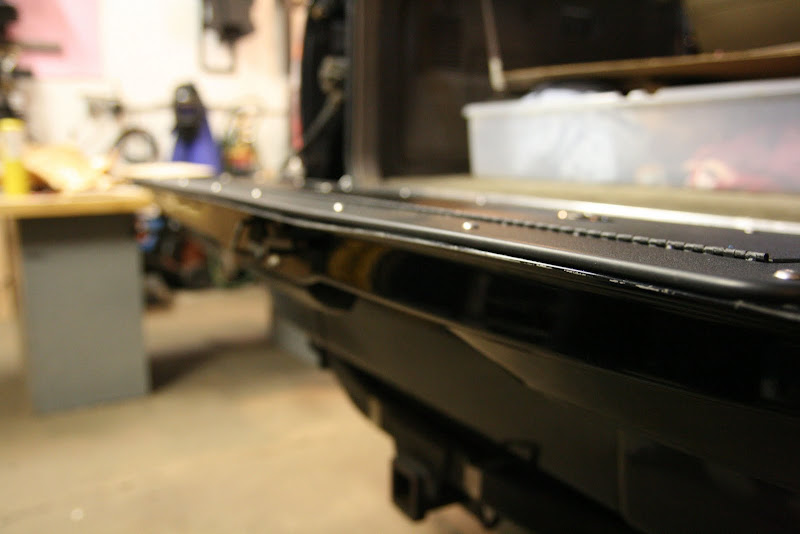

There are two things to note, the first is the subtle arc of the lid upwards.
I get a number of questions about that, think of it like a bridge or an empty flatbed trailer. I weld the frames together on a jig that has that bend to it so that when the lid gets bolted down to the tailgate, everything is in tension.
You can see the task this lid has on hand, it needs to pull Rami's bent tailgate back into shape.

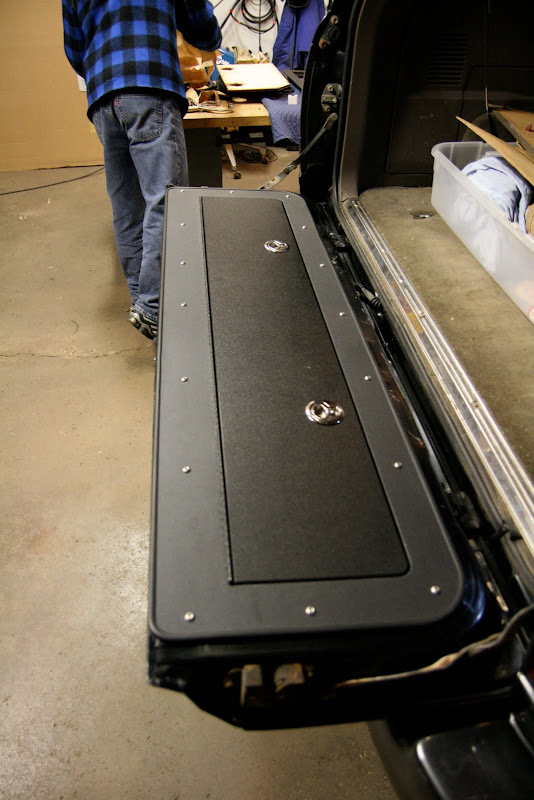

Here is the same lid bolted in place, we pulled the main dent out as best we could, but notice that everything is nice and snug now. And the tailgate is nice and sturdy again.

We ran a bit short on the sound deadening, I've updated the amount needed accordingly. The center part still needs to be covered, but we took care of the harder to reach areas.
Here it is all buttoned up.

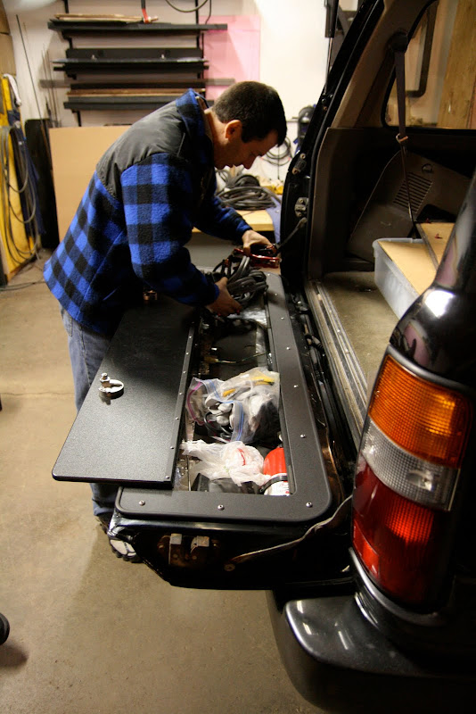

And here is Rami actively engaged in the final common step, called "Lets See What Will Fit!"
