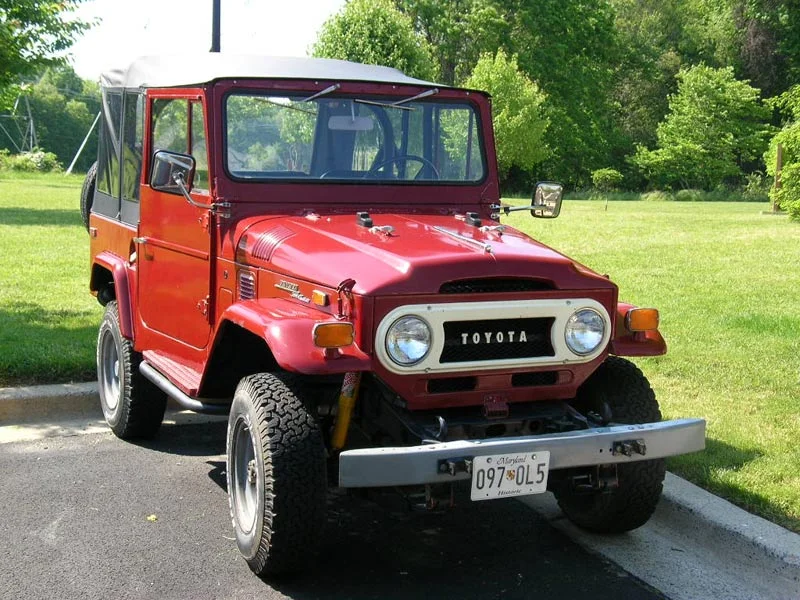

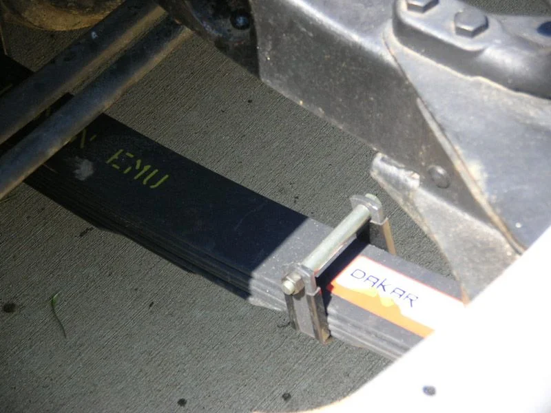

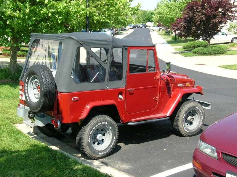

Can you tell? 2.5" OME on 30" tires. 33" Super Swampers on the docket, but not for a while. Oh yeah, no "pretty filter" this time - I actually washed and waxed the beast. The hood turned out to be a different shade of red. Oh yeah, rides nicer too.
Summary: Don't believe the 'MUD members who say a lift will "only take three hours" to complete. It took Ryan seven hours to finish, and he is good. Had to use the acetylene torch (twice) to burn the pin bushing on the front passenger's side, a 30-ton press to flatten the pin "flange" out again, and a belt sander to remove the hardened bushing on the pin. We both took turns with the silver slapper to finally get the pin out. And this was a lift that went well.

7 hours is not too bad. My fastest was 3 hours to put emu on my FJ60 where the truck was one owner and rust free but my 79 FJ40 the lift took me three days to put on because every fastener was a fight!

Thanks! It probably wouldn't have taken nearly as long if we weren't reusing the pins. If I had new pins we probably would've been more medieval with the existing ones.
