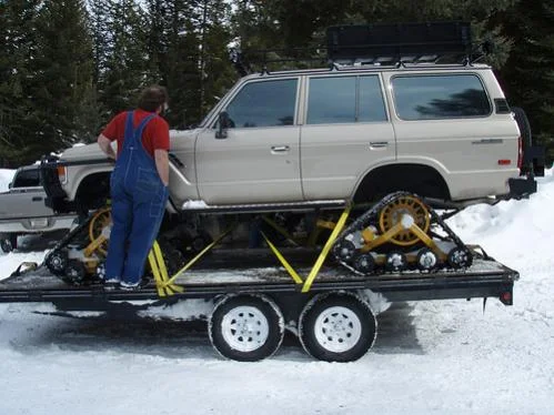

Do you think this truck makes my butt look to big???
Just curious ... Cahil

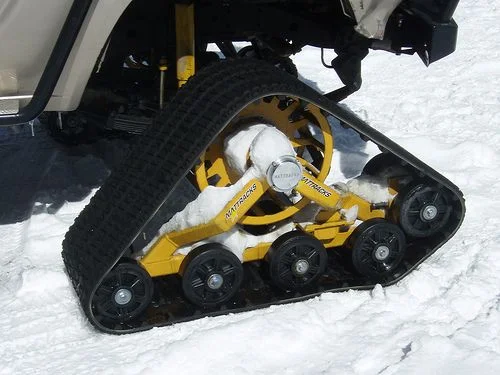

MatTrack closeup ...

Can you drive that on the street and what is the top speed? It looks like you can remove the tracks and put on regular tires and wheels?

That's the plan. Starting to go through it system by system and just figure out what I really have here. It took almost half a week for the truck to de-thaw. Remember it was practically frozen all the time. Block heaters really do work well in the winter time. Theoretically the original wheel studs were not cut to install the MatTracks so it should be possible to bolt up normal tires.
Power steering is leaking a bit but should be 'ok'. Turning the MatTracks was a real chore for the steering box. Per manufacture the top speed on the tracks is 40mph. I don't believe those are street legal.
The fuel injector pump has a manual hard line to turn off and on. The first time is weird. You pull the cable out to start, throw out the clutch and crank to start. After started you can take the keys out of the ignition switch and the motor just keep running. You need to push the fuel control cable back in to cut the fuel off to starve the engine to stop. The glow screen is hooked up to a momentary push button. Much simpler and less computer crap under the hood.
