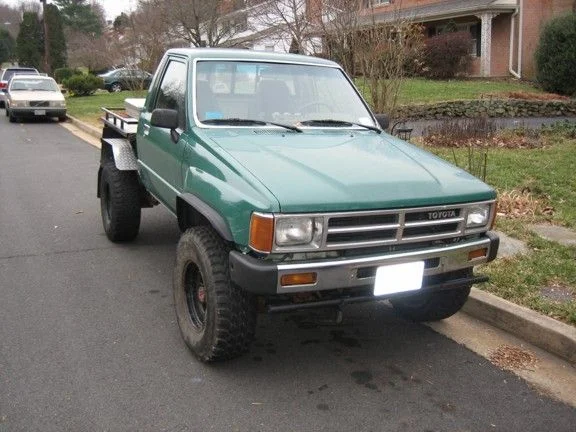

Here was my solution for fender flares...
Since i try to keep the spending on my trucks to a minimum (yes, this hobby can get quite expensive!!!), I looked to do it on the cheap. In order to get through inspection, i needed fender flares since the tires stuck out a few inches past the body. In DC, i guess it is not allowed.
So i went to home depot and hunted around... this is what I came up with. Vinyl base. $4/4feet lengths. comes in black and gray and a few other colors. I chose the black.
I cut it up, measured up the holes, and had to add a small piece of aluminum sheet to keep it rigid at the flat part of the fender. Bolted it between the body and the plastic insert.
Total cost of project.... $8, per side, plus tax.
What do you think???

interesting use for rubber cove base....nice job

Great idea. Nice job.

best use I've seen for vinyl base

Looks good! Another good excuse to HD.

Excellent job, Seb!
