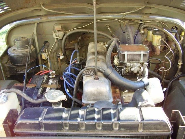

Weber "washable" air filter?
Hi guys...
My weber carb is using a filter that I think is gauze...its white and wrapped in a fine wire mesh. I've heard that these things are washable....but how?
Then, if I do wash it....is this the type of filter that requires oil?
Thanks for any insight....
Doug

K&N makes a filter recharge kit. Should work well with this type of filter. Contains cleaning solvent and re-oil mix. Will need to let the filter air dry (overnight?) before re-oiling. Note: be sure to wash the filter in the reverse of the air flow.
K&N is not the only stuff which will work but an easy to find solution.
I wouldn't be to surprised if K&N made that filter but as a non-branded item.

Hey Cahil, thanks for the information.
I've never oiled this thing...just pulled it from the packaging and slapped it on. So, do they really need to be oiled?

It needs to be oiled if you want it to collect anything smaller than pea gravel. I've got the oil; if you're in the New Baltimore/Warrenton Metroplex area just stop by.

The filters are pre-oiled form the factory. I bet the package you pulled it from was a sealed cellophane or plastic wrapper ?
After cleaning they need to be dried and then oiled. If your vehicle does not have a Mass Air Flow sensor (MAF) theses are great filters. There have been issues with over oiling and confusing/contaminating the MAF.

Thanks for the information guys. I will just order one of those "re-charge" kits with the cleaner and the oil.

BTW, is that a new radiator?

That is the radiator that came with the truck...why? Is it in good shape relative to yours?

It's shinier.
