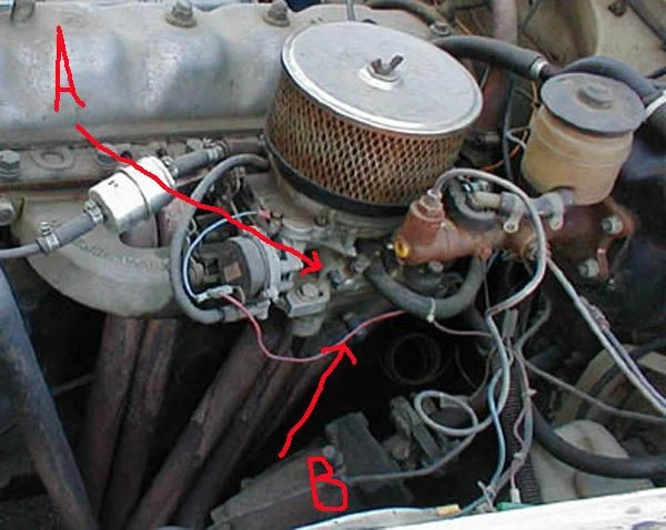

As most of you know, I'm planning on replacing my Carter AFB 4-barrel carb with a stock Aisin carb that's currently being rebuilt by JimC. He just told me he expects to be done with it within a week, so now I need to make sure I've got all the other parts I need to do the swap back to stock. Here's a pic of my current set-up; please excuse the lines I drew on it - it's the only pic I could find.

- Intake gasket - I want to keep the header that's on there. will a regular gasket work?
- Fuel lines - Currently, my fuel return line is a soft line that's cut off and plugged down near the fuel pump, and my fuel hard line is cut off before the carb to allow that fuel filter, then a soft line into the carb. I'm pretty sure the Aisin carb needs the hard lines with fittings going into it. Should I use the whole hard lines and put the filter before the pump like the stock configuration? Just get a short bit of line and a fitting and use the current setup? Can I run soft lines all over for feed and return, and just use short bits of hard line at the carb and pump?

I have a spare Felpro gasket that I used with my headers, you are welcome to it.

Felix, is something wrong with your header? Why're you going back to stock exhaust?
On the fuel tubing, not sure what size you need to resurrect original, or what the end style is - I think it might be a push connect style, but I have 71475 on http://www.mastercool.com/m54.html. If I have the correct dies and size (we need to check in mm) I can make them up. Plus, you may be able to purchase from the dealer the missing lines. You *could* probably use rubber, but stock uses steel, so there must be a good reason why.

Dan, thanks for the info. There's a guy somewhere here on MUD that was selling some fuel lines he was bending up. I might check with him once I have the new carb in hand. Not being a stickler for the details, I would much rather just run soft lines all over. Unless that's bad for some reason.
Oh, and I'm not getting rid of the header, just the carb and intake manifold. I'll need to remove the header to get to the gasket, but I'm just going to put it right back on.
