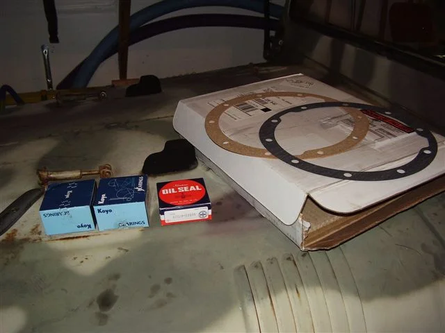

I got the parts from cruiseroutfitters today.
2 bearings
1 box of seal(s)...I didn't look inside yet, but now I'm guessing there should be two seals in there.
2 differential gaskets.
Since we'll be pulling the rear axles to get the diff out...won't I need a couple more gaskets that go behind the drums??
Doug

If you're replacing both rear wheel seals and bearings, then yes, you are missing a rear axle seal. One rear axle seal and bearing per side. There are no gaskets behind the rear drums, only the rear axle seals.
Are your rear wheel seals leaking? Why are you replacing the rear seals/bearings just to change a diff out?

Dumb question - why are there two diff gaskets?

Cork is for rear cover, paper is for diff.

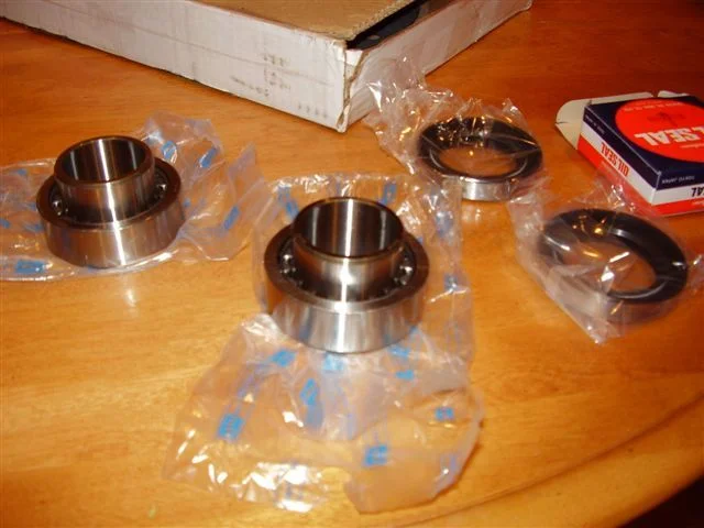

Doug, Open up one of the bearing boxes, tear open the plastic bag and lets see what the bearing looks like. Also, open up the seal box to verify you have two seals in there... You will need one per side.

Hey John, I'll do that tonight.

...1 box of seal(s)...I didn't look inside yet, but now I'm guessing there should be two seals in there....
There is two seals in each box
That literally everything you need. There is one other paper gasket between the dust sheild and the axle shaft, but it only gets replaced when you are popping the studs out of your axleshaft, and even at that you don't really need the paper gasket. Your set...
Here are the bearings and seals from cruiseroutfitters.
