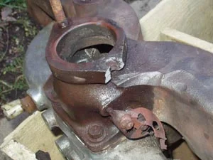

nevermind... bolt extractor broke off... i tried to chisel it out with a punch... cracked the manifold.... here are pics of the remains...

Looks like it's time for a header...
http://www.marksoffroad.net/specials/TriY-Header.html
Mark is a great vendor, kind of hard to get a hold of but a very nice guy.
I am usually a fan of the stock manifold but it might be hard to find the right one for your truck. Someone on pirate is selling a complete 74 F, maybe he'd sell just the manifold.
FYI, you usually can't mix and match intakes and exhaust manifolds. They are milled together meaning not all are the same thickness. You might be able to find one that is close, but better to get a matched pair.
On one of my 40's I had a crack like that where I was able to gind a flat spot and just use a nut and bolt instead of a stud and bolt. Kind of cheddar but it worked.
Check your DC smog laws before you get a header. Technically not legal here VA.
